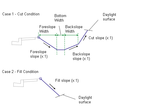

Input Parameters
Note: All dimensions are in meters or feet unless otherwise noted. All slopes are in run-over-rise form (for example, 4 : 1) unless indicated as a percent slope with a “%” sign.

Behavior
The attachment point is tested to determine if it is in cut or fill. If it is in fill, the fill daylight link is extended to the Daylight Surface at the given Fill Slope. If in cut, the foreslope, ditch bottom, and backslope are added, and the cut daylight link is extended from the end of the backslope to the Daylight Surface at the given Cut Slope.
This subassembly optionally lets you add a lined material. You can specify three ranges of slopes. Material type 1 is applied if the slope of the links is up to the specified slope value. From slope 1 to slope 2, the second type of material applied. Similarly, if the slopes of links fall within slope 2 and slope 3 values, then material 3 is applied. If the link slopes are flatter than slope limit 3, then no material is applied.
If a lined material is added to the subassembly, then parallel links are added to the daylight links with specified thickness. Bottom level links are coded with Datum and daylight links are coded with Top. Shapes enclosed by these materials are coded with material name.

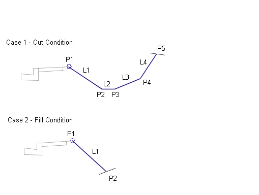

Point, Link, and Shape Codes
The following table lists the point, link, and shape codes for this subassembly that have codes assigned to them. Point, link, or shape codes for this subassembly that do not have codes assigned are not included in this table.
Point, Link, or Shape |
Codes |
Description |
P1 |
Hinge Hinge_Fill |
Fill condition only - hinge point for fill daylight link |
P2 |
Ditch_In
Daylight Daylight_Fill |
Cut condition only - inside edge of ditch
Fill condition only - daylight point |
P3 |
Ditch_Out |
Cut condition only - outside edge of ditch |
P4 |
Hinge_Cut |
Cut condition only - hinge point for cut daylight link |
P5 |
Daylight Daylight_Cut |
Cut condition only - daylight point |
L1 - L4 |
Top Datum |
Unpaved finish grade |
L1 |
Top Datum Daylight Daylight_Fill |
Daylight link in fill |
L4 |
Top Datum Daylight Daylight_Cut |
Daylight link in cut |
Coding Diagram
