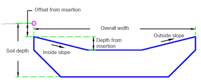

The ClarkCountyRainGardenNoCurb subassembly inserts links to create a Clark County Rain Garden with no curb.
You should verify that the dimensions used match your interpretation of the standard plan.
The attachment point is at the inside edge of the inside slope. This component can be attached to either the left or right side.
Input Parameters
Note: All dimensions are in meters or feet unless otherwise noted. All slopes are in run-over-rise form (for example, 4 : 1) unless indicated as a percent slope with a “%” sign.
Parameter
Description
Type
Default
Side Specifies which side to place the subassembly Left / Right Right
Overall Width Overall width of rain garden Numeric, positive
12.0 ft
3.6 m
Soil Depth Soil depth of rain garden Numeric, positive
2 ft
0.6 m
Inside Slope Inside slope Slope -4 ( : 1)
Outside Slope Outside slope Slope -4 ( : 1)
Depth From Insertion Depth from insertion Numeric
-1 ft
0.3 m
Offset From Insertion Offset from insertion Numeric
0 ft
0 m
Target Parameters
This section lists the parameters in this subassembly that can be mapped to one or more target objects. For more information, see To Specify Corridor Targets.
None.
Runtime Logical Assignments
None.
Output Parameters
None.
Behavior
The initial point is set at the attachment point. The rain garden is then adjusted the entered offset distance. The depth of the rain garden is set from the input values.
Layout Mode Operation
In layout mode, this subassembly draws the rain garden in accordance with the input parameters.
Point, Link, and Shape Codes
The following table lists the point, link, and shape codes for this subassembly that have codes assigned to them. Point, link, or shape codes for this subassembly that do not have codes assigned are not included in this table.
Point, Link, or Shape
Code
Description
P1 RG_Insertion Rain garden insertion point
P2 RG_Top_In Rain garden top inside
P3 RG_Top_Out Rain garden top outside
P6 RG_Btm_Out Rain garden bottom outside
P7 RG_Btm_In Rain garden bottom inside
L1-L3 Top, RG_Slope Top of rain garden slope
L5-L7 Datum Datum
L6 Datum, RG_Btm Rain garden bottom
S1 RainGarden Rain garden
