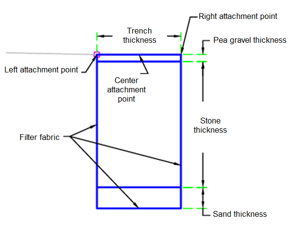

The InfiltrationTrench subassembly inserts links to create an infiltration trench. The subassembly is based on requirements of the County of Los Angeles Low Impact Development Standards Manual, dated February 2014.
You should verify that the dimensions used match your interpretation of referenced document.
The attachment point is at the top left, top center, or top right side of the infiltration trench.

The initial point is set at the attachment point. The subassembly builds the shape for the infiltration trench.
Layout Mode Operation
In layout mode, this subassembly displays the infiltration components based on the input parameters given.
