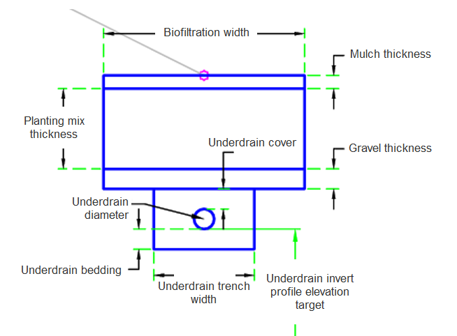

The BioRetention subassembly inserts links to create a bioretention area with three layers and an optional underdrain. The subassembly is based on requirements of the County of Los Angeles Low Impact Development Standards Manual, dated February 2014.

The attachment point is at the middle top of the bioretention.

Biofiltration Width Biofiltration width Numeric, positive
5 ft
1.5 m
Mulch Thickness Thickness of mulch Numeric, positive
0.33 ft
0.10 m
Planting Mix Thickness Planting mix thickness under mulch Numeric, positive
2.0 ft
0.6 m
Gravel Thickness Gravel thickness under planting mix Numeric, positive
0.5 ft
0.15 m
Include Underdrain Include underdrain to remove water Yes/ No Yes
Underdrain Diameter Underdrain diameter Numeric, positive
0.5 ft
0.15 m
Underdrain Cover Underdrain cover Numeric, positive
0.5 ft
0.15 m
Underdrain Bedding Bedding under the underdrain pipe Numeric, positive
0.5 ft
0.15 m
Underdrain Trench Width Underdrain trench width Numeric, positive
2.5 ft
0.75 m

The initial point is set at the attachment point. The subassembly builds a mulch layer followed by a planting mix layer, followed by a gravel layer. If set to include an underdrain pipe the subassembly builds an underdrain pipe and pipe bedding.
