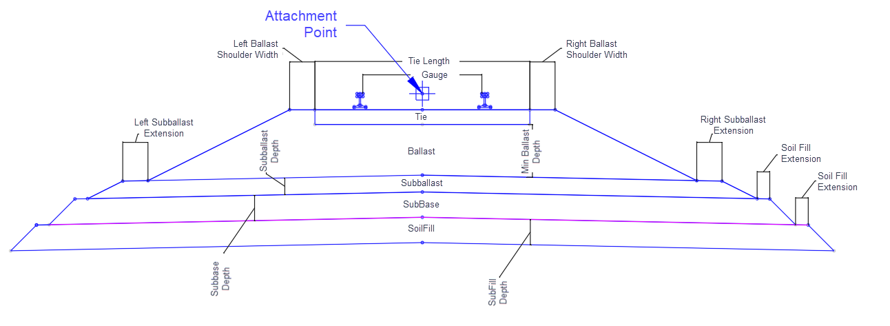

By default, the attachment point is at the centerline between the rails. The track can be moved relative to this point using the subassembly parameters.
Input Parameters

| Tie Plate Thickness | Thickness of the tie plate which is also the distance from the bottom of the rail to the top of the tie. | Numeric, non-negative | 1"
25 mm |
| Rail Base to Ballast | Distance from the bottom of the rail to the top of the ballast. If this value is equal to the tie plate thickness, then the top of the ballast is flush with the tops of the ties. | Numeric, non-negative | 1"
25 mm |
| Tie Length | Length of the tie (also known as sleeper). | Numeric, non-negative |
8.5' 2.59 m |
| Tie Depth | Depth of tie | Numeric, non-negative | 7"
178 mm |
| Minimum Ballast Depth | The minimum vertical distance between the bottom of the tie and the top of the Subballast. The location of this minimum distance changes at different stages in cant. See "Behavior" below. | Numeric, non-negative | 2 ft
0.6096 m |
| Ballast Shoulder Width (Left and Right) | The distance from the end of the tie to the beginning of the ballast side slope. | Numeric, non-negative | 12"
305 mm |
| Ballast Side Slope (Left and Right) | The slope of the side of the ballast material. The slope of the top of the ballast material matches the slope of the tie that results from cant. | Slope, non-negative | 2:1 |
| Subballast Depth | The depth of the subballast material | Numeric, non-negative | 8"
203 mm |
| Subballast Top Slope | The top slope of the left and right sides of the subballast with the centerline of the subassembly as the hinge point. | Slope, non-negative | 40:1 |
| Subballast Extension (Left and Right) | The distance from the toe of the ballast material to the beginning of the side slope of the subballast material | Numeric, non-negative | 12"
305 mm |
| Subballast Side Slope (Left and Right) | The slope of the side of the subballast material. | Slope, non-negative | 2:1 |
| Sub_Base Extension (Left and Right) | The distance from the toe of the subballast material to the beginning of the side slope of the subbase material | Numeric, non-negative |
0.5 ft 0.15 m |
| Sub_Base Slope | The slope of the side of the SubBase material. | Slope, non-negative | 1:1 |
| Sub_Base Depth | The depth of the SubBase material | Numeric, non-negative |
1 ft 0.30 m |
| Soil Fill Depth | The depth of the Soil Fill material | Numeric, non-negative |
1 ft 0.30 m |
| Soil Fill Slope | The slope of the side of the Soil Fill material. | Slope, non-negative | 1:1 |
| Soil Fill Extension (Left and Right) | The distance from the toe of the subbase material to the beginning of the side slope of the Soil Fill material | Numeric, non-negative |
0.5 ft 0.15 m |

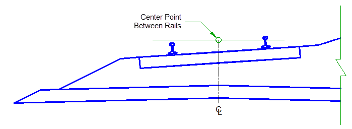

This subassembly provides a simple single rail design with adjustable cant and material components.

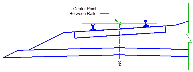

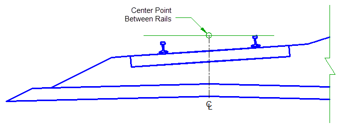

If you set the Pivot Method to High Side Rail, then the rail on the outside of the curve is held at track elevation and the elevation of the inside rail is adjusted an amount equal to the cant value.
If you set the Pivot Method to Center Baseline, then both rails are adjusted an amount equal to half the cant value, the outside rail upward and inside rail downward.
The Minimum Ballast Depth value applies at the location of the minimum clearance between the tie and subballast. The Subballast Top Slope parameter independently controls the subballast top slope . The Baseline to Subballast Crown parameter controls the location of the subballast crown.

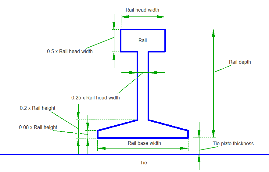

Rail Detail
The rail shape used in this subassembly is a simplified approximation of industry standard rail shapes and dimensions. Rail Head Width, Rail Depth, and Rail Base Width are available as input parameters and are used to derive the remaining approximated dimensions.

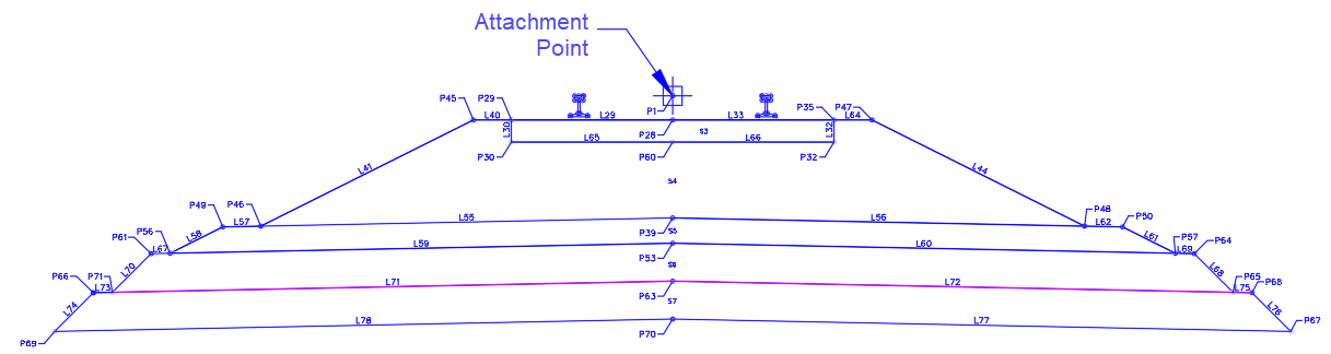

Point, Link, and Shape Codes
The following table lists the point, link, and shape codes for this subassembly that have codes assigned to them. Point, link, or shape codes for this subassembly that do not have codes assigned are not included in this table.
Point, Link, or Shape |
Code |
Description |
| P1, P4-P13 | Rail | Rail |
| P2 | Cl_Rail | Centerline of Rail |
| P3 | Gauge_Line,Rail | Gauge line (inside edge of top of rail) |
| P14, P18, P19, P23 | Top_Edge_Ballast | Top edge of the ballast material |
| P15, P17, P20, P22 | Tie | Top corner of tie |
| P16,P21 | CL_Tie | Centerline of tie at top |
| P26, P30 | Top_Edge_Subballast | Top edge of the subballast material |
| P27, P29 | Bottom_Edge_Ballast | Bottom edge of the ballast material |
| P28 | Top_Subballast | Top of subballast material at centerline |
| P31, P33 | Bottom_Edge_Subballast | Bottom edge of the subballast material |
| P32 | Bot_Subballast | Bottom of subballast material at centerline |
| P63 | Bottom_SoilFill | Bottom_SoilFill |
| P64 | Top_Edge_SoilFill | Top_Edge_SoilFill |
| P62, P65 | Bottom_Edge_SoilFill | Bottom_Edge_SoilFill |
| P66 | Top_Edge_SubBase | Top_Edge_SubBase |
| P67 | Bottom_Edge_SubBase | Bottom_Edge_SubBase |
| P68 | Top_Edge_SubBase | Top_Edge_SubBase |
| P69 | Bottom_Edge_SubBase | Bottom_Edge_SubBase |
| P70 | Bottom_SubBase | Bottom of SubBase |
| L1, L2 | Top_Rail, Rail | Top of rail |
| L3-L13 | Rail | Rail |
| L14, L17, L22, L23 | Ballast,Top | Top of ballast |
| L15,L16 | Tie, Top_Tie | Top of tie |
| L18-L21 | Tie | Tie |
| L24, L27-L29 | Subballast, Top | Top of subballast |
| L25, L26, | Ballast, Subballast | Ballast and subballast |
| L30, L31 | Subballast, Datum | Bottom of subballast |
| L32 | Ballast,Ballast_Between_Ties | Ballast material in open space between ties. Can also be used when ties are omitted. |
| L67-L70 | Top, SoilFill | SoilFill |
| L71-L72 | SoilFill, SubBase | SubBase |
| L73-L76 | Top, SubBase | SubBase |
| L77-L78 | SubBase, Datum | SubBase |
| S1, S2 | Rail | Rails |
| S3 | Tie | Tie |
| S4 | Ballast | Ballast |
| S5 | Subballast | Subballast |
| S6 | SoilFill | SoilFill |
| S7 | SubBase | SubBase |
Coding Diagram
