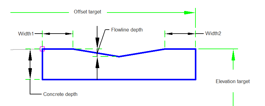

The ValleyGutterSimple subassembly is a concrete valley gutter with user defined widths, concrete depths, and flow line depth. The width can be modified and the flowline stays at the center.
The attachment point is at the inside edge of the valley gutter.

Side Specifies which side to place the subassembly. Left/Right Right
Concrete Width Width of the concrete gutter. Numeric, positive
5 ft
1.5 m
Flowline Depth Depth of the valley gutter from the top of the ditch to the flowline. Numeric, positive
0.08 ft
0.02 m
Width1 Width of the valley gutter on the side of the attachment point. Numeric, positive
0.5 ft
0.15 m
Width2 Width of the valley gutter on the opposite side of the attachment point. Numeric, positive
0.5 ft
0.15 m
Concrete Depth Depth of the concrete measured from the attachment point. Numeric, positive
0.75 ft
0.2 m

May be used to override the fixed Width and tie the edge-of-shape to an offset aligning. The following object types can be used as targets for specifying this offset: alignments, polylines, features lines, or survey figures. Optional
Flowline Elevation
May be used to override the flowline depth and tie the flowline elevation to the elevation of a profile. The following object types can be used as targets for specifying this elevation: profiles, 3D polylines, feature lines, or survey figures. Optional

This subassembly will insert a simple valley gutter. The location of the width of the subassembly can be specified with a fixed width, or with an optional alignment. The valley gutter can be specified with a fixed depth, or a profile can be assigned to control the depth.
Layout Mode Operation
In layout mode the subassembly displays the links comprising the valley gutter with the user input values.

P1 Top, Hinge
P2 Datum
P3 Datum, Concrete
P4 - P6 Top
P7 Flowline, Top
L1, L3 Concrete
L2 Datum, Concrete
L4 - L7 Top
S1 ValleyGutter
