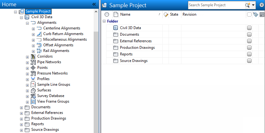

Autodesk Vault provides a stand-alone application that you can use to manage project files and users. The Autodesk Vault client window, shown in figure 10, uses a table to show project files and data about these files.
Figure 10: Autodesk Vault window
In the tool window, you can see all project files, including system files.
The window also lists all drawings where the selected file is used as a reference and displays DWF™ versions of the drawing files, so you can quickly find the version you need.
You can use the Autodesk Vault client to conduct many administrative activities. An Autodesk Vault administrator can delete unwanted files, set up working folders, and manage file access for individual users or groups, as described in User Access Controls.
Using the Vault client, you can restore a previous version of a file without restoring the entire project. If you need to create a new drawing using an existing drawing as the basis, use the Copy Design option in the Vault client to do this without opening the source drawing.
