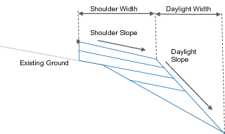

This subassembly inserts a shoulder for widening situations that will trim the base and subbase layers based on the location of the existing ground surface.
The attachment point is at the inside edge of the shoulder on the finish grade surface.

Shoulder Width |
Width of the paved shoulder |
Numeric |
Shoulder Slope |
Slope of the paved shoulder |
Numeric |
Behavior
When inserted, this subassembly checks for the presence of the target existing ground surface. If this surface exists, then the base and subbase surfaces will be trimmed to the existing ground.
If the surface does not exist, then this shoulder behaves the same as the ShoulderExtendAll subassembly.

Point, Link, or Shape | Code | Description |
P2 | EPS | Edge of paved shoulder, finish grade |
P4 | EPS_Pave1 | Edge of paved shoulder on Pave1 |
P6 | EPS_Pave2 | Edge of paved shoulder on Pave2 |
P8 | EPS_Base | Edge of paved shoulder on Base |
P10 | Daylight_Sub | Subbase daylight point |
L1 | Top, Pave | Paved finish grade |
L3 | Pave | Paved finish grade |
L4 | Pave1 | Top of Pavement2 |
L6 | Pave1 | Top of Pavement2 |
L7 | Pave2 | Top of Pavement3 |
L9 | Pave2 | Top of Pavement3 |
L10 | Base | Top of the base course |
L12 | Base | Top of the base course |
L13 | SubBase, Datum | Bottom of subbase, datum |
L14 | Top | Top surface formation |
S1 | Pave1 | |
S2 | Pave2 | |
S3 | Base | |
S4 | SubBase |
Coding Diagram
