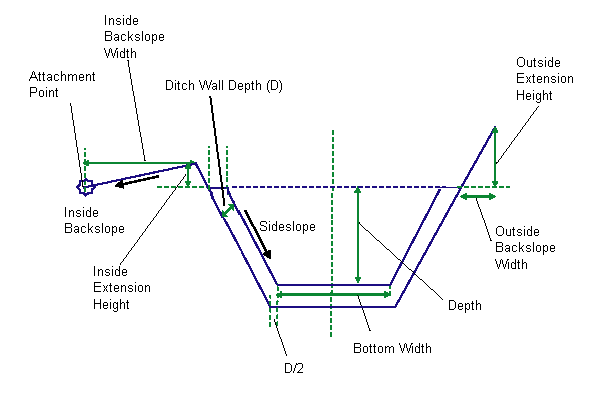

The subassembly is used to create a ditch structure with optional backslope and foreslopes.
The attachment point is the innermost point on the grading links preceding the ditch structure. If grading links are omitted, then the attachment point is the innermost point on the inside wall of the ditch structure (shown in blue circle).
Input Parameters
Note: All dimensions are in meters or feet unless otherwise noted. All slopes are in run-over-rise form (for example, 4 : 1), unless indicated as a percent slope with a “%” sign.

Behavior
The subassembly builds the shape for a ditch structure, as shown in the above illustration.
In Civil 3D 2010 and previous versions, the Ditch Wall Depth parameter was measured vertically. In Civil 3D 2011 and later, this parameter is measured perpendicular to the side of the slope. Therefore, if you open a drawing containing these subassemblies that was created in Civil 3D 2010 or prior in Civil 3D 2011 or later, and then rebuild the corridor(s), this parameter will be changed to reflect the new behavior. Any volume reports that use this subassembly will be updated to reflect the new behavior.
Layout Mode Operation
In layout mode, this subassembly is created outward, starting from the attachment point, as defined using the input parameters.
