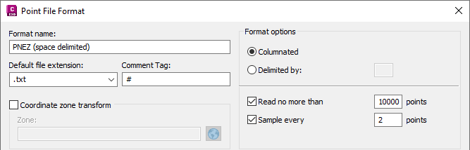

To filter a point file on import
- In Toolspace, on the Settings tab, expand the Point
Point File Formats collection. - Right-click the file type you want to import
Properties. - In the Point File Format dialog box (figure 1), set the options on the lower right to limit the total number of points and set a sampling rate.
Figure 1: Settings for point file filtering
This type of filtering often makes sense when using LIDAR data, which contains points in a dense grid.
