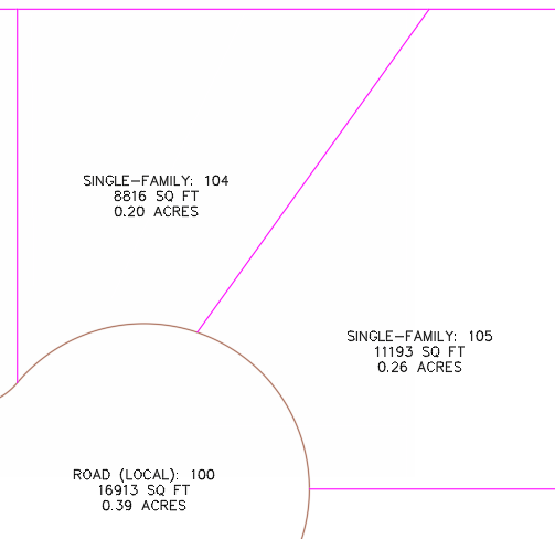

Figure 7: Frontage preview line

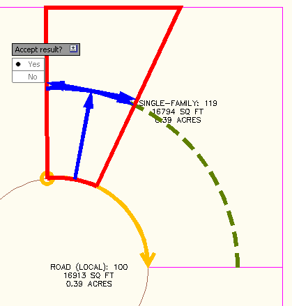

- Preview graphics display if the proposed solution is correct. The green dashed line represents the frontage offset as shown in figure 8. Accept the resulting solution or enter No to end the command so that you can adjust the sizing parameters.
Figure 8: Preview of proposed solution and frontage offset line
