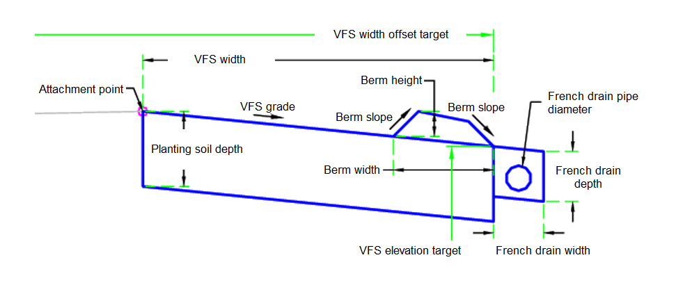

The VegetatedFilterStrip subassembly inserts links to create a vegetated filter strip to treat storm water.
The attachment point is at the inside edge of the Vegetated Filter Strip. This component can be attached to either the left or right side.

Side | Specifies which side to place the subassembly | Left / Right | Right |
Include French Drain Outlet | Include French drain outlet at end of filter | Yes / No | Yes |
Berm Slope | Slope of berm | Numeric, positive | 1 ( : 1) |
Berm Width | Width of berm | Numeric, positive |
2 ft 0.60 m |
Berm Height | Height of berm | Numeric, positive |
0.5 ft 0.15 m |
Include Berm at Toe | Include berm at toe to contain water | Yes / No | Yes |
Planting Soil Depth | Planting soil depth | Numeric, positive |
1.5 ft 0.45 m |
Include Planting Soil | Include planting soil | Yes / No | Yes |
VFS Grade | Vegetated filter strip grade | Numeric | -10% |
VFS Width | Vegetated filter strip width | Numeric, positive |
15 ft 4.5 m |
French Drain Pipe Diameter | French drain pipe diameter | Numeric, positive |
0.5 ft 0.15 m |
French Drain Depth | French drain depth | Numeric, positive |
1 ft 0.3 m |
French Drain Width | French drain width | Numeric, positive |
1 ft 0.3 m |

Starting at the attachment point, a finish grade surface and parallel subgrade are inserted using the given width and depth. Vertical links close the shape at either end of the vegetated filter strip. An optional berm is built at the far end of the vegetated filter strip. An optional French drain is constructed at the end of the vegetated filter strip.

Coding Diagram
