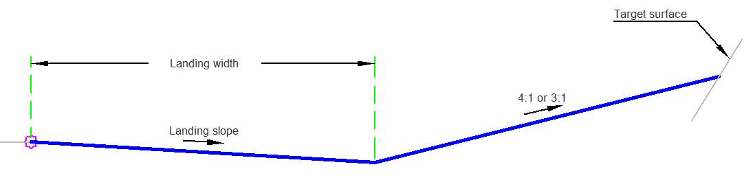

The SimpleCutWithLanding subassembly allows a simple landing/shoulder with a cut option. The subassembly only daylights in a cut situation.
The attachment point is the innermost point on the grading links preceding the landing.

Behavior
The landing is drawn using the input parameters. The height to daylight is then calculated. If the distance is less than 25 ft (7.5 m) a daylight slope of 4:1 is used. If the height is less than 35 ft (10.5 m) a daylight slope of 3:1 is used. Otherwise a daylight slope of 2:1 is used.
If in fill, the daylight slope is not created.
Layout Mode Operation
In layout mode the subassembly displays the links comprising the landing and a link for the daylight in cut.

P1 Top, Hinge
P2 Top, LandingOuter Outer Landing Point
P3 Daylight_point Daylight Point
L1, L2 Top
Coding Diagram
