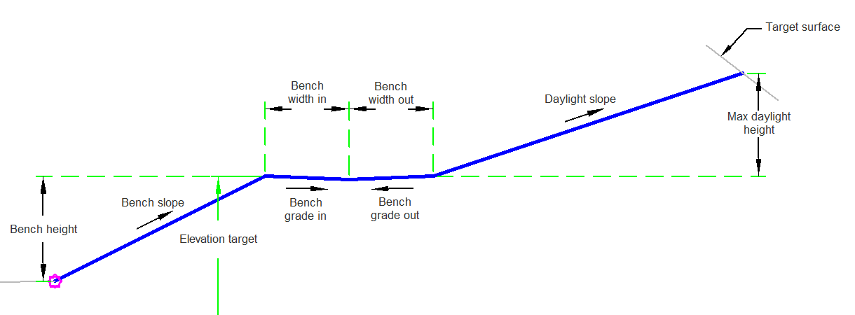

Behavior
The initial hinge point is set at the attachment point. The hinge point elevation is checked against the target surface to determine if the section is in the cut or fill condition. The first link is then built to the target elevation or if not, set to the bench height. The bench links are added. The hinge point is reset to the outside edge of the bench and a daylight link is then found.

L1 - L4 Top
Coding Diagram
