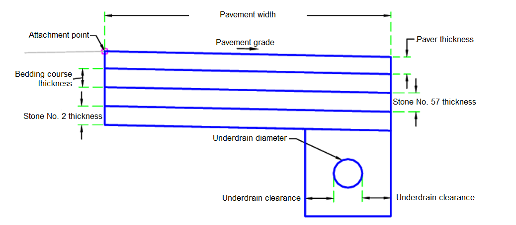

The PermeablePavement subassembly inserts links and shapes to create permeable pavement pavers with an optional underdrain.
The attachment point is at the inside edge of the permeable pavement. This component can be attached to either the left or right side.

Behavior
The slope of the permeable pavement is determined by the input parameters or, if set, the offset targets. The shape of the permeable pavement is built from the input parameters. If set to use an underdrain, an underdrain pipe and surrounding material is constructed. The location of the underdrain is at the edge of the pavement, unless the targets change the location and elevation. If set to include an impermeable liner, link codes are assigned to the bottom and outer sides of constructed links.

Coding Diagram
