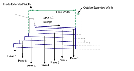

This subassembly creates a cross-sectional representation of a lane comprised of multiple layers. The layers can be of varying widths. It also applies the Outside Lane superelevation slope value for the corridor model's baseline alignment.
The attachment point is at the inside edge of lane on the finish grade surface. This component can be attached to either the left or right side.

Each layer has its own separate extension options both on the inside and outside. The inside and outside extensions specify the additional width on the inside or outside relative to the pavement layer immediately above.

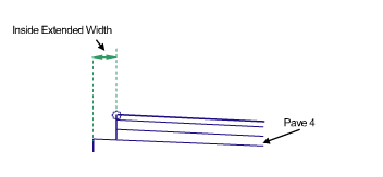

Example 1:
Pave4 Inside Extended Width = 0.5m
Pave4 Outside Extended Width = 0m
If inserted on the right side,

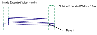

Example 2:
Pave4 Outside Extended Width = 0.6m
The extension widths will always be specified as positive widths.
The pavements layer widths may be specified using the following methods:
- By specifying that the pavement width will be the same as the pavement immediately above.
- By specifying a pavement width.
By specifying an inside and outside pavement layer extended width so that pavement layer width will be the distance between the inside and outside offsets.
By specifying an inside pavement layer extended width and pavement width so that the outside pavement layer is automatically calculated.

Point, Link, and Shape Codes
The following table lists the point, link, and shape codes for this subassembly that have codes assigned to them. Point, link, or shape codes for this subassembly that do not have codes assigned are not included in this table.
Point/Link | Codes | Description |
P1 | ETW | Edge-of-traveled-way on finish grade |
P1 | Crown | Crown point on finish grade (optional) |
P2 | Lane | Outside edge of lane on finish grade |
P3 | ETW_Pave1 | Edge-of-traveled-way on the Pave1 layer |
P3 | Crown_Pave1 | Crown point on the Pave1 layer (optional) |
P4 | Lane_Pave1 | Outside edge of lane on the Pave1 layer |
P5 | ETW_Pave2 | Edge-of-traveled-way on the Pave2 layer |
P5 | Crown_Pave2 | Crown point on Pave2 layer (optional) |
P6 | Lane_Pave2 | Outside edge of lane on the Pave2 layer |
P7 | ETW_Pave3 | Edge-of-traveled-way on the Pave3 layer |
P7 | Crown_Base | Crown point on Pave3 layer (optional) |
P8 | Lane_Base | Outside edge of lane on the Base layer |
P9 | ETW _Sub | Edge-of-traveled-way edge of lane on the Subbase layer |
P9 | Crown_Sub | Crown point on subbase layer (optional) |
P10 | Lane_Sub | Outside edge of lane on the Subbase layer |
L1 | Top, Pave | Finish grade surface |
L2 | Pave1 | |
L3 | Pave2 | |
L4 | Base | Base surface |
L5 | SubBase | Subbase surface |
S1 | Pave1 | |
S2 | Pave2 | |
S3 | Base | |
S4 | SubBase |
Coding Diagram
