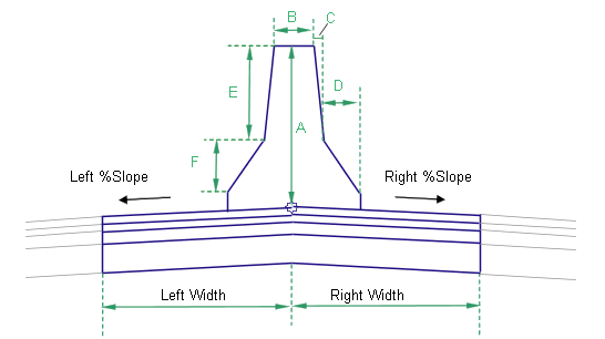

This subassembly inserts surfaces to define a flush median with an optional New Jersey Barrier.
The pavement structure follows the standards described in “Pavement Structure of Paved Sections" in the Autodesk Civil 3D Help.
The attachment point is at the center of median on the finish grade surface. This component inserts to the left and right side simultaneously.
Input Parameters
Note: All dimensions are in meters or feet unless otherwise noted. All slopes are in run-over-rise form (for example, 4 : 1) unless indicated as a percent slope with a “%” sign.

Include Barrier |
True shows the New Jersey barrier. False omits the barrier. |
Selection list |
Include Barrier |
Left Width |
Width from the median centerline to the left edge of median |
Numeric, positive |
1.2 m 4.0 ft |
Right Width |
Width from the median centerline to the right edge of median |
Numeric, positive |
1.2 m 4.0 ft |
Left Lane - Use Superelevation |
Specifies to use superelevation slope for the left lane |
Selection list:
Yes |
Default Left Slope |
Specifies the default slope of the left lane, if superelevation slope is not specified | Numeric |
- 2 % |
Right Lane - Use Superelevation |
Specifies to use superelevation slope for the right lane. |
Selection list:
Yes |
Default Right Slope |
Specifies the default slope of the right lane, if superelevation slope is not specified | Numeric |
- 2 % |
Shoulder Slope Direction | Specifies whether the shoulder slopes away from the crown or towards the crown |
Selection List:
Away from Crown |
Pave1 Depth |
Thickness of the Pave1 layer; zero to omit |
Numeric, positive |
0.025m 0.083 ft |
Pave2 Depth |
Thickness of the Pave2 layer; zero to omit. |
Numeric, positive |
0.025 m 0.083 ft |
Base Depth |
Thickness of the base layer |
Numeric, positive |
0.100 m 0.333 ft |
Subbase Depth |
Thickness of the subbase layer |
Numeric, positive |
0.300 m 1.0 ft |
Dimension A (mm or inches) |
Height of the barrier at the center of median |
Numeric, positive |
810 mm 32 in |
Dimension B (mm or inches) |
As shown in diagram |
Numeric, positive |
232 9 in |
Dimension C (mm or inches) |
Numeric, positive |
59 mm 2 in |
Dimension D (mm or inches) |
Numeric, positive |
125 mm 5 in |
Dimension E (mm or inches) |
Numeric, positive |
557 mm 22 in |
Dimension F (mm or inches) |
Numeric, positive |
178 mm 7 in |

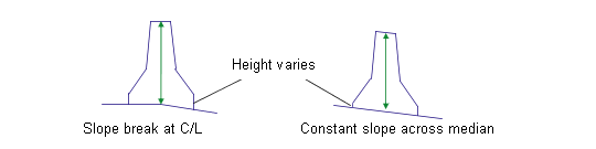

Behavior
The pavement structure links are inserted outward left and right of the attachment point for the given widths and slopes. If the Include Barrier value is True, a New Jersey barrier is inserted symmetrically about the median centerline. If alignments are given as target parameters for the Left and Right Widths, the widths are adjusted to tie to the alignment offsets at each station along the corridor.
If the median is in superelevation with a single constant slope across the entire median, the top of the barrier is slanted to match the median slope. Otherwise the top of the barrier remains horizontal. In all cases, the barrier height (Dimension A) is held constant at the centerline of the barrier.

Layout Mode Operation
In layout mode, this subasssembly displays all pavement links using the width and depth input parameters at a -2% slope. If Include Barrier is True, the barrier is displayed with the given dimensions.
