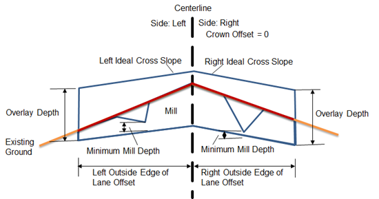

This subassembly adds an overlay layer on top of an existing crowned roadway with a milling layer added as required.
The attachment point is the crown point of the overlay layer with finished ground cross slope.

Overlay Depth Depth of the overlay layer. Numeric, positive 0.600m (0.600 ft)

Left Ideal Cross Slope Specifies user defined left ideal cross slope. Numeric, negative -2.00%
Left Minimum Mill Depth The minimum mill depth between the bottom of the milling layer to the bottom of the existing ground layer on the left side. Numeric, positive 0.300m (0.300 ft)
Left Slope Tolerance Tolerance for varying the left overlay slope. Numeric 0.50%
Right Ideal Cross Slope Specifies user defined right ideal cross slope. Numeric, negative -2.00%
Right Minimum Mill Depth The minimum mill depth between the bottom of the milling layer to the bottom of the existing ground layer on the right side. Numeric, positive 0.300m (0.300 ft)
Right Slope Tolerance Tolerance for varying the left overlay slope. Numeric 0.50%

This subassembly assumes that no leveling layer is added.
Point, Link, and Shape Codes
The following table lists the point, link, and shape codes for this subassembly that have codes assigned to them. Point, link, or shape codes for this subassembly that do not have codes assigned are not included in this table.
Point, Link, or Shape Code Description
P1 Crown Crown point for top of overlay
P2, P3 EOV Overlay edges on finished grade for the left and right side of the road
P4 Crown_Overlay Crown point for bottom of mill
P5, P6 EOV_Overlay Edges of bottom of mill for the left and right side of the road
P7, P8 EOV_Milling Edges of top of mill for the left and right side of the road
P9 Crown_offset Offset of the crown point from attachment point.
L1, L2 Top, Pave Top of overlay for left and right side of road
L3, L4, L5, L6 Overlay Links for the overlay layer.
L7, L8 Mill Mill links (height) for left and right side of road
S1 Overlay Area between the top and bottom of overlay
S2 Mill Area between the top and bottom of mill
