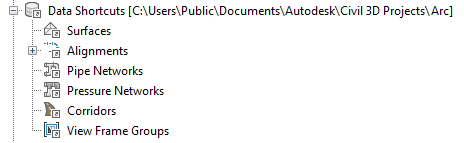

Data shortcuts can be created only for surfaces, alignments, profiles, corridors, pipe networks, pressure networks, and view frame groups. They provide reference links between drawings without the use of a database. When you create data shortcuts from a drawing, they appear on the Data Shortcuts node of the Prospector tree. From this location, you can insert a reference object into another open drawing by right-clicking its shortcut, or by dragging and dropping the shortcut into the current drawing.
Figure 3: Shortcuts as they appear on the Prospector tree
