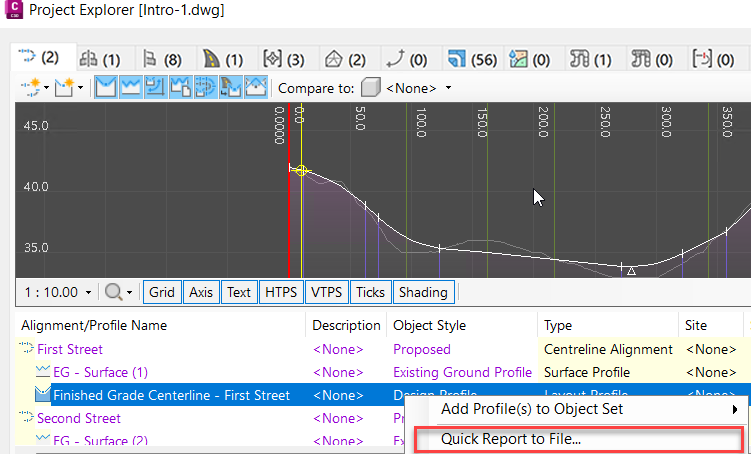

- On the Alignments tab of the Project Explorer window, locate the alignment Second Street, and right-click the associated profile: Finished Grade Centerline - Second Street Design.
- Select
Quick Report to File from the right-click menu.

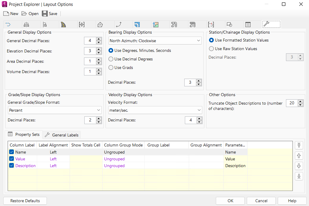

- From the Alignment/Profile Options controls, set a desired Line, Curve, and Spiral interval for the outgoing Quick Report.
- Select the General tab and note the options here to set the format of numerical values such as angles/bearings, stations, elevations, and slopes. Changes applied here will only affect the outgoing Quick Report.
- Click OK to close the Layout Options dialog and return to the Quick Report dialog.

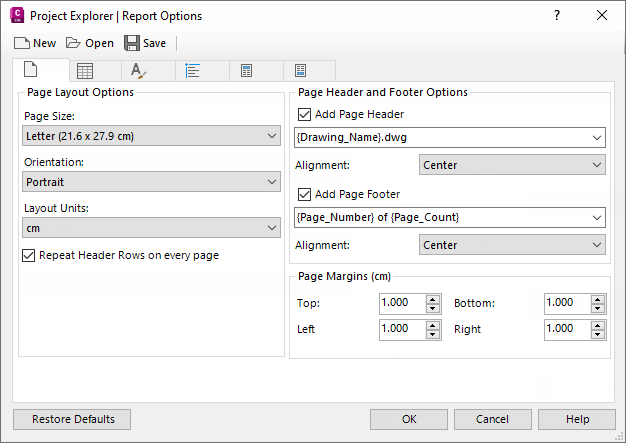

Report Options dialog opens.
- On the Page Options tab, set the Page Size to A4, and the page orientation to Portrait.
- On the Font Options tab, set the Preferred Font to Corbel and the font size to 10pt.
- On the Table Options tab, set the Header Row Background Color to Pale Yellow, or a color of your choice.
- Optionally, on the Report Header tab, select the Add Image to Header checkbox and click the Browse button to select a company logo image file from your computer.
- Finally, click OK to close the Report Options dialog and return to the Quick Report dialog.

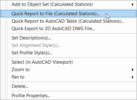

On the Alignments tab of the Project Explorer window, relocate the alignment Second Street, and right-click the associated Finished Grade Centerline - Second Street Design Profile.
Ensure that the Calculated Stations sub-object tab is selected, then right-click the selected profile and select Quick Report to File (Calculated Stations) from the right-click menu.

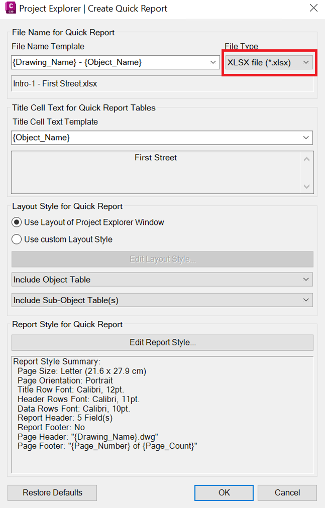

The Create Quick Report dialog box opens.
Configuring the report for export to Excel

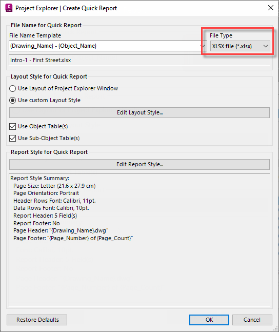

Change the file type to XLSX file to generate an Excel file.
As you have previously configured your report settings, you can just accept the current layout style and report style, or you can make some minor adjustments if you wish.
- Click the OK button to generate the file.
