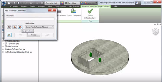

The Add Assembly Connector dialog will be displayed.
- Input a port name in the Add Assembly Connector dialog. For example, enter Underground Structure Port for a port that will connect a surface structure to an underground structure.
- Click the Set Position icon
- Click to place the assembly connector on the desired face and/or work plane in your shape model.
Be careful to also specify the proper direction for the assembly connector(s) you add. You can click Change Direction
or Flip Direction
to modify the design direction for your assembly connectors.
