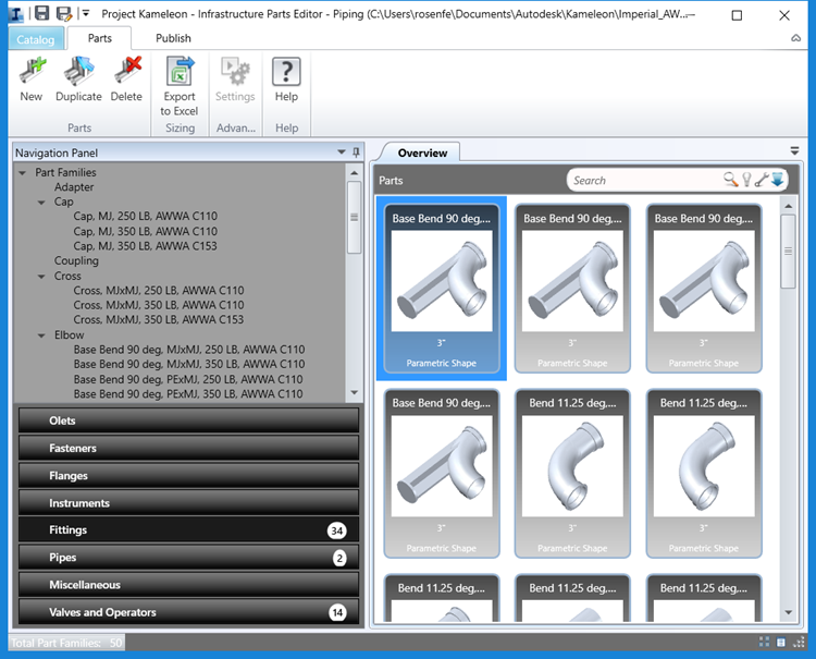

    Note: The Plant3D piping data you imported is converted to .ACCat file format and saved to C:\Documents\Autodesk\Kameleon by default.
  6. Click Open by File.
  7. Select the .ACCat file that was created and click Open.
    The piping catalog opens to the Parts tab and the Overview tab displays a preview of parts within the catalog.
