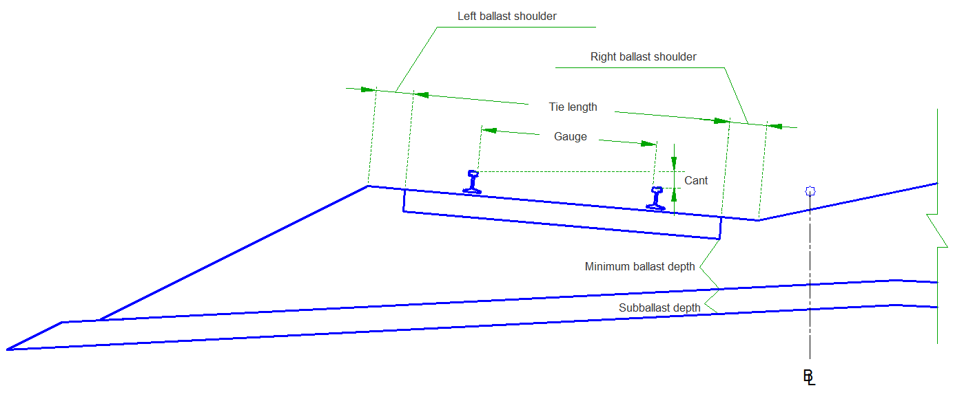

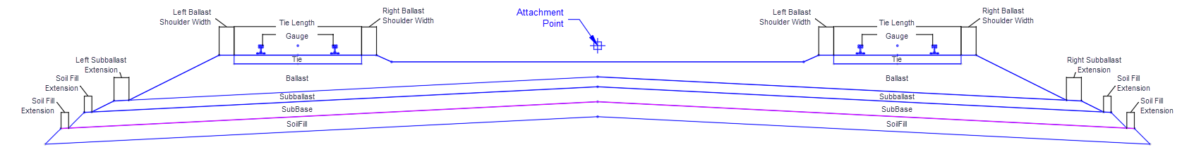

The RailDoubleTrackCANT subassembly is used to insert the rails, ties, ballast, subballast, soil fill, and subbase for a double-track railroad.
It should be followed with a Daylight subassembly on the left and right sides to close to existing ground in cut and fill situations. It is capable of responding to rail cant.
By default, the attachment point is at the centerline between the rails of the left track. The tracks can be moved relative to this point using the subassembly parameters.
Input Parameters

| Baseline to Right Track CL |
The offset from the baseline alignment to the centerline of the left or right track. |
Numeric |
0 |
| Baseline to Left Track CL |
Numeric |
20' 6m |

| Rail Base to Ballast |
Distance from the bottom of the rail to the top of the ballast. If this value is equal to the tie plate thickness, then the top of the ballast is flush with the tops of the ties. |
Numeric, non-negative |
1" 25 mm |
| Tie Length |
Length of the tie (also known as sleeper). |
8.5' 2.59 m |
| Tie Depth |
Depth of tie |
7" 178 mm |
| Minimum Ballast Depth |
The minimum vertical distance between the bottom of the tie and the top of the Subballast. The location of this minimum distance changes at different stages in cant. See "Behavior" below. |
12" 305 mm |
| Ballast Shoulder Width (Left and Right) |
The distance from the end of the tie to the beginning of the ballast side slope. |
1 ft 0.30 m |
| Ballast Side Slope (Left and Right) |
The slope of the side of the ballast material. The slope of the top of the ballast material matches the slope of the tie that results from cant. |
Slope, non-negative |
2:1 |

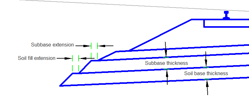

| Sub_Base Slope |
The slope of the side of the SubBase material. |
1:1 |
| Sub_Base Extension |
The distance from the toe of the subballast material to the beginning of the side slope of the SubBase material |
0.5' 150 mm |
| Sub_Base Depth |
The depth of the SubBase material |
12" 300 mm |
| Omit SubBase |
Prevents the SubBase points, links, and shapes from being drawn. If the Omit Ballast, Omit Subballast, or Omit Soil Fill option is set to Yes then the SubBase is not drawn regardless of this setting. |
Yes/No |
No |
| Soil Fill Slope |
The slope of the side of the Soil Fill material. |
1:1 |
| Soil Fill Depth |
The depth of the Soil Fill material |
12" 300 mm |
| Soil Fill Extension |
The distance from the toe of the soil fill material to the beginning of the side slope of the Subballast material. |
0.5' 150 mm |

Behavior
When no targets are applied, the location of either track is determined by the Left Track Offset, Right Track Offset, Left Track Elevation Difference, and Right Track Elevation Difference. These values locate the center points between the tracks. By default, the Left Track Offset is zero placing the centerline of the left track at the baseline. When target alignments and profiles are applied, these values are overridden. When using target alignments for the track centerlines, the tracks always remain perpendicular to the baseline, not the target alignment. When the target alignments are not parallel to the baseline alignment, distortion will occur and the track dimensions will not be accurately represented.
If you set the Pivot Method to High Side Rail, then the rail on the outside of the curve is held at track elevation and the elevation of the inside rail is adjusted an amount equal to the cant value.
If you set the Pivot Method to Center Baseline, then both rails are adjusted an amount equal to half the cant value, the outside rail upward and inside rail downward.
The Minimum Ballast Depth value applies at the location of the minimum clearance between the tie and subballast. The Subballast Top Slope parameter independently controls the subballast top slope . The Baseline to Subballast Crown parameter controls the location of the subballast crown.
