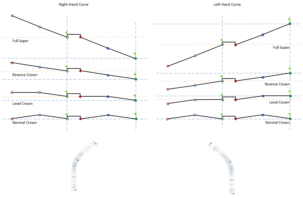

Pivot at Right Side - Maintain Median Shape (Superelevation on Divided Crowned Roads)
The following illustration describes the Right Side pivot method for a divided crowned roadway.
Maintain Median Shape means when superelevation is applied, the median will raise to accommodate the superelevation. This option maintains the median shape, and the pivot points raise or lower.
For an explanation of superelevation diagrams, see About Superelevation Axis of Rotation Pivot Methods.
