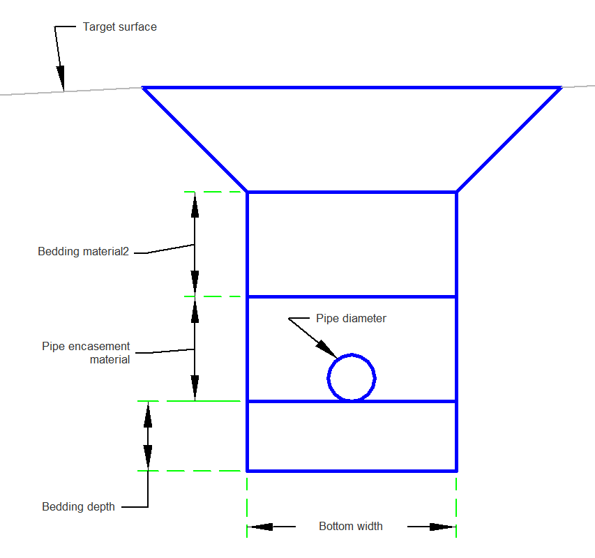

The PipeTrenchMultipleLayers2 subassembly has a single pipe in a trench, a layer of material encasing the pipe, and an additional layer of material above the pipe encasement.
This subassembly allows volume calculation of bedding base, pipe zone, and granular backfill. The pipe is encased in a layer of material right above the bedding. The center of pipe is the design profile. The depth of topmost layer of the trench will vary; the other pipe trench layers are constant depths. All of the depths, widths and diameters will change from trench to trench. The depth of the trench will vary along the alignment since it is measure from the bottom of the trench to the target surface.

By default, the attachment point is the center of the pipe.

The elevation of the bottom of the trench is calculated as the profile grade line elevation minus half the pipe diameter plus the bedding depth. The horizontal trench bottom link is placed symmetrically about the attachment point offset at that elevation. The pipe encasement material depth is used to provide for material around the pipe. Above the pipe encasement material is Material2 to provide material above the pipe. The side slopes are extended upward to the existing surface. The horizontal bedding link is placed at the given depth above the trench bottom.
