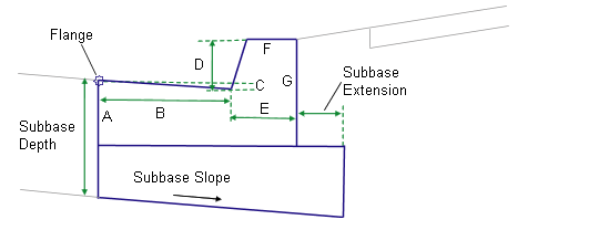

This subassembly inserts links for a standard shape concrete curb-and-gutter with subbase.
User-defined input parameters control the dimensions of the shape.
The attachment point is at the flange point of the gutter or the back of the curb.
Input Parameters
Note: Subbase dimensions are in meters or feet. Curb-and-gutter dimensions must be given in millimeters or inches.

Dimension A
(mm/in)
Depth of the gutter at the flange point
Numeric, positive,
non-zero
175 mm
7 in
Dimension B
(mm/in)
Width from the flange point to the gutter flowline
400 mm
16 in
Dimension C
(mm/in)
Depth from the flange point to the gutter flowline
Numeric, positive,
non-zero
25 mm
1 in
Dimension D
(mm/in)
Height of curb from the gutter flowline to the top-of-curb
Numeric, positive,
non-zero
150 mm
6 in
Dimension E
(mm/in)
Width from the gutter flowline to the back-of-curb
Numeric, positive,
non-zero
200 mm
8 in
Dimension F
(mm/in)
Width of the top-of-curb
Numeric, positive,
non-zero
150 mm
6 in
Dimension G
(mm/in)
Height of the back-of-curb
Numeric, positive,
non-zero
325 mm
13 in
Behavior
The curb and gutter links are inserted based on the Input Parameter dimensions Dimension A – Dimension F. All dimensions must be positive, non-zero values. If a non-zero subbase depth is given, the subbase layer is inserted to the back of curb, and continues for the Subbase Extension width. The subbase layer closes to the bottom-back-of-curb, as shown in the diagram.
The subassembly builds the shape for a simple curb and gutter, with the attachment point either at (a) inside edge of the gutter (or lip), or (b) the back of the curb. The face of the curb is given a small, constant width to make it non-vertical.
