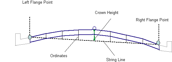

This subassembly inserts parabolic travel lanes, to represent finish grade, pavement, and subbase for urban, parabolic lanes between known flange points. The parabolic shape is simulated by a series of short, straight-line links.
To use this subassembly, you should have separate alignments defining the left and right flange points. Elevations at these points could come from surfaces or profiles. Furthermore, if the component defining the edges (for example, curb and gutter) is also a rehab component, then they could be passed in as marked points, thus transferring offset and elevation information.
The attachment point is (near) the crown point of the subassembly. Since the subassembly places lanes on either side of the crown, this attachment point is typically at the assembly baseline point. While in the layout mode this point coincides with crown point, in the corridor state the finished grade profile point (or baseline marker point) may not be the same as crown point, as crown point offset and elevation are computed by input data such as left and right (flange point) offset values.

Initial attachment point is just a place holder (and more applicable in layout mode). First two points to establish are left and right edges, whose offsets and elevations are determined based on input parameters.
Then a string line is defined by joining the left and right flange points (which are newly established edges of travelways). This string line is divided by "number of increments" parameter and middle one is taken as "crown point" offset. Crown point elevation is established by adding the 'crown height" parameter to the elevation of midpoint on the string line.
The ordinates of the parabolic curve at other tesselated points are calculated using standard vertical curve equations, based on the assumption that the string line is horizontal. Straight line links are added to connect the ordinate points in a series (from left edge to crown point to right edge) to define the finish grade. A parallel surface is inserted at the overlay depth below this finish grade.
