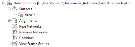

Default shortcut project template: icons on the Prospector tree
Default shortcut project template: folder structure in the working folder
Keep the top-level _Shortcuts folder and its object-specific subfolders as the storage location for shortcut XML files, but feel free to create other folders for drawings.
