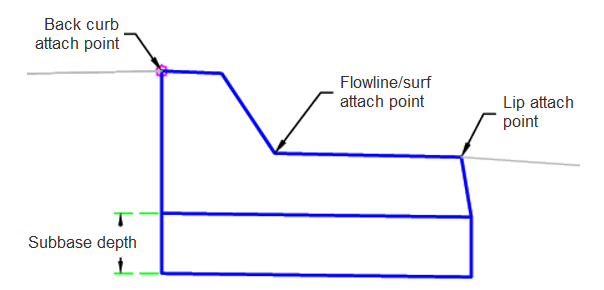

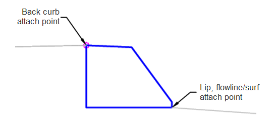

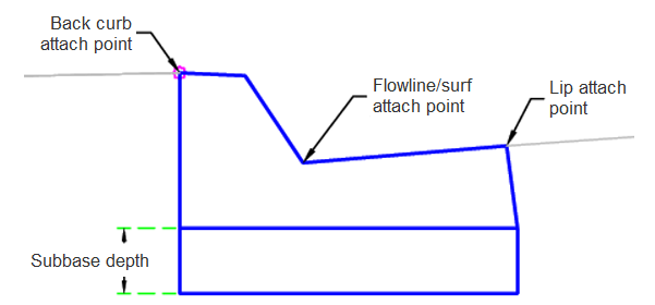

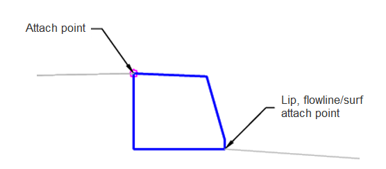

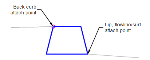

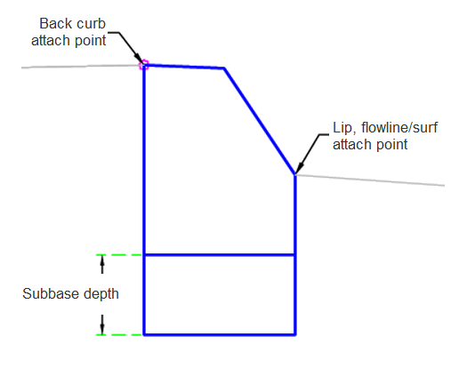

The APWACurbs subassembly inserts links for a standard shape concrete curb-and-gutter with subbase. The curb and gutter dimensions are based on the APWA Standard Plans for Public Works Construction, 2012 edition.
You should verify that the dimensions used match your interpretation of the standard plan.
APWA Curbs A1-6 and A1-8

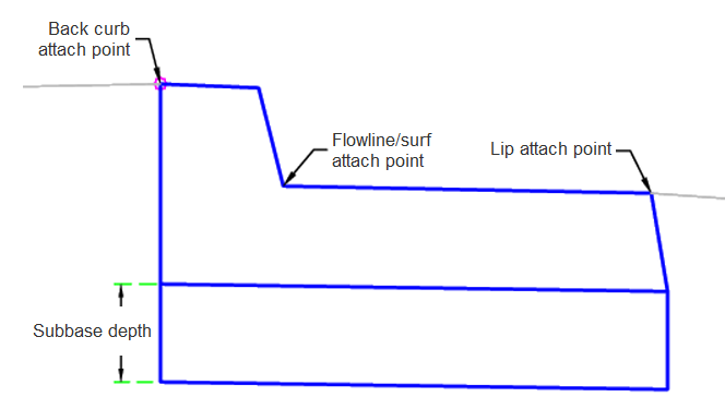

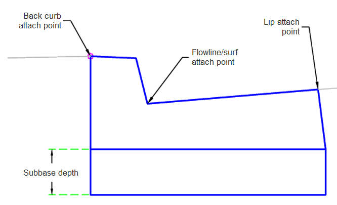

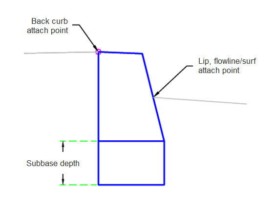

The attachment point is at the flange point of the gutter, the back of the curb, or the face of the curb.

Curb Type Specifies the curb to be used. A1-6 / A1-8 / A2-6 / A2-8 / A3-6 / A3-8 / D1-6 / D1-8 / C1-6 / C1-8 / B1-6 / B2-6 / B3-6 / D2-6 / C2-6 A1-6
Attach Point Specifies where the curb attach point is. Lip/ BackCurb / Flowline-Surface
10.0 ft
3.0 m
Subbase Depth Depth to subbase at the flange point. Use zero if there is no subbase. Numeric, Positive
0.5 ft
0.150 m

The curb and gutter links are inserted based on the values stored within the subassembly. All dimensions are positive, non-zero values. If a non-zero subbase depth is given, the subbase layer is not inserted. The subbase layer closes to the bottom-back-of-curb.
The subassembly builds the shape for the selected curb, curb and gutter, or surface curb, with the attachment point either at (a) inside edge of the gutter (or lip), or (b) the back of the curb or (c) the flowline (or surface) of the curb or gutter.
