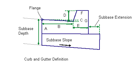

This subassembly is used to replace an existing curb and gutter, with the sod strip tying to the existing inside edge of sidewalk. The vertical placement of the curb and gutter is controlled by a design profile of the back of curb.
To apply this subassembly, flange point information (alignment or offset value) is essential.

The following are the same parameters as CurbAndGutterGeneral subassembly. | |||
Subbase Depth |
Depth to subbase at the flange point. Use zero if there is no subbase. |
Numeric, positive |
0.450 m 1.5 ft |
Subbase Extension |
Distance the subbase is extended beyond the back-of-curb. Use zero to terminate the subbase at the back-of-curb. |
Numeric, positive |
0.3 m 1 ft |
Subbase Slope Method |
Selects whether to use the Outside Lane superelevation slope for the subbase layer, or to set a numeric % slope value |
Selection list |
Fixed Slope |
Subbase %Slope |
% slope of the subbase layer. Not used if Use SE is set to True. |
Numeric |
-2 (%) |
Dimension A (mm/in) |
Depth of the gutter at the flange point. |
Numeric, positive, non-zero |
175 mm 7 in |
Dimension B (mm/in) |
Width from the flange point to the gutter flowline. |
400 mm 16 in |
Dimension C (mm/in) |
Depth from the flange point to the gutter flowline. |
25 mm 1 in |
Dimension D (mm/in) |
Height of curb from the gutter flowline to the top-of-curb. |
150 mm 6 in |
Dimension E (mm/in) |
Width from the gutter flowline to the back-of-curb. |
200 mm 8 in |
Dimension F (mm/in) |
Width of the top-of-curb. |
150 mm 6 in |
Dimension G (mm/in) |
Height of the back-of-curb. |
325 mm 13 in |

This subassembly is used to place a new curb and gutter parametrically, and can optionally tie (with a sod strip) into either the inside edge of the existing sidewalk, or to a new sidewalk created with another subasembly. The horizontal placement of the curb and gutter is determined from the previously know flange point location. Highside of the sod strip can be located either by a fixed offset or any other marked point, such as inside edge of sidewalk. Alternatively this point can come from the target parameter of an aligment and profile. Newly designed flange point, optionally marked so that it can be used as input later for replacement lane subassemblies.
Key steps in completing this conditional subassembly are as follows:
- From flange point offset and the input parameters locate the offset of “back of curb”.
- From the target parameter, get the "back of curb" elevation at that station and establish this point P4.
- From this point establish all curb and gutter points and links using the input parameters (similar to UrbanCurbGutterGeneral1
- If inside sidewalk marked point is assigned, establish that point as P10. If marked point is not associated, look for target parameters for "inside edge of sidewalk" alignment. If yes then get profile elevation or from the surface target parameter.
- If none of the above data is available for the highside of the sod strip, use the offset as dictated by attachment point to establish point P10.
All other curb and gutter links are inserted based on the Input Parameter dimensions Dimension A - Dimension F. All dimensions must be positive, non-zero values. If a non-zero subbase depth is given, the subbase layer is inserted to the back of curb, and continues for the Subbase Extension width. The subbase layer closes to the bottom-back-of-curb as shown in the diagram.
Layout Mode Operation
In layout mode the subassembly is set based on the attachment point and the default flange point offset from baseline. Width of the sod strip is computed by subtracting the curb and gutter total width from "flange point to attachment point" distance. Use 2% slope to calculate the low side of sod strip (or back of curb point), from which the rest of curb and gutter is drawn using the input parameters given.
