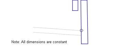

This subassembly creates a simple guardrail shape on the assembly.
This subassembly is one of a group of Getting Started subassemblies used for simple roadway modeling, and for tutorial and training purposes.
The attachment point is at the inside edge of the post at finish grade level.

The subassembly builds two rectangular shapes for the post and railing. The dimensions are fixed, and cannot be changed by the user. The post extends downward from the attachment point for a fixed distance below finish grade.
Layout Mode Operation
In layout mode, this subassembly draws the post and rail with the fixed dimensions.
Point, Link, and Shape Codes
The code “Guardrail” is assigned to all points. No link or shape codes are assigned.
