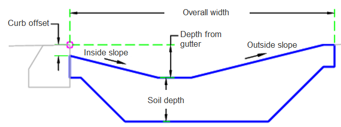

The ClarkCountyRainGardenV subassembly inserts links to create a Clark County Rain Garden V, adjacent to the curb.
You should verify the dimensions used match your interpretation of the standard plan.
The attachment point is at the inside edge of the inside slope. This component can be attached to either the left or right side.

Side Specifies which side to place the subassembly Left / Right Right
Overall Width Overall width of rain garden Numeric, positive
12.0 ft
3.6 m
Depth From Gutter Depth from the adjacent attach point. Numeric
-1.0 ft
0.3 m
Soil Depth Depth of soil Numeric, positive
2 ft
0.6 m
Curb Offset Offset from the attachment point Numeric
-0.5 ft
0.15 m
Inside Sideslope Inside sideslope Slope -4 ( : 1)
Outside Sideslope Outside sideslope Slope -4 ( : 1)

The initial point is set at the attachment point. The rain garden in then adjusted the entered offset distance. The depth of the rain garden is set from the input values.
Layout Mode Operation
In layout mode, this subassembly draws the rain garden in accordance with the input parameters.

P1 RG_Gutter Rain garden insertion point
P2 RG_Top_In Rain garden top inside
P3 RG_Top_Out Rain garden top outside
P6 RG_Btm_Out Rain garden bottom outside
P7 RG_Btm_In Rain garden bottom inside
L1-L3 Top, RG_Slope Top of rain garden slope
L5-L7 Datum Datum
L6 Datum, RG_Btm Rain garden bottom
S1 RainGarden Rain garden
