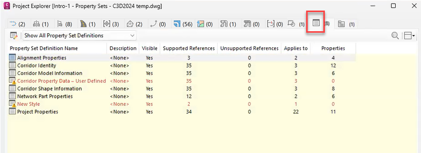

Working in the Property Sets Definitions Tab
The Property Set Definitions Name list view displays all property set definitions in the drawing. The Property Set References list displays all references associated to the property set you selected in the first list view and all properties of selected references are displayed in the list in the bottom right corner.
To add or remove a property set reference:
  1. Select a property set definition from the Property Sets Definitions tab. The associated property set references for the definition will displayed.
  2. Select a reference in canvas/viewport and click to add a property set reference. Click to remove the selected property set reference. You can also remove a property set reference by right clicking a reference and selecting Remove Selected Property Set.
