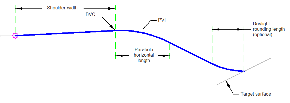

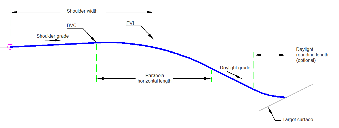

The ShoulderParabolicDaylight subassembly provides rounding at the Point of Vertical Intersection (PVI) between the shoulder and daylight links as well as fillet rounding between the daylight link and target surface.
In addition, you have the option to either define the shoulder width dimension from the origin to the PVI or from the origin to the BVC (Beginning of Vertical Curvature).
Origin to PVI Case:
Origin to BVC Case:
