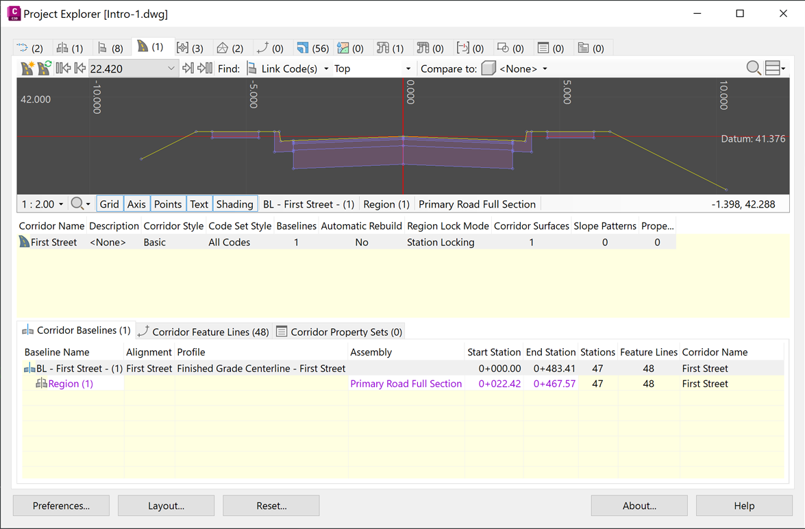

Adjusting Pane Layouts in the Project Explorer window
Pane Layout buttons are situated in the top-right corner of each of the key Object Category tabs. These buttons are used to control the layout of each individual pane of information in the selected tab, and are an ideal way to simplify the user interface in cases where the full set of information panes is not required to carry out a given task.

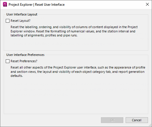

Reset user interface
To reset the user interface preferences and/or layout at any time, clicking the Reset button in the lower left corner of the main Project Explorer window.
