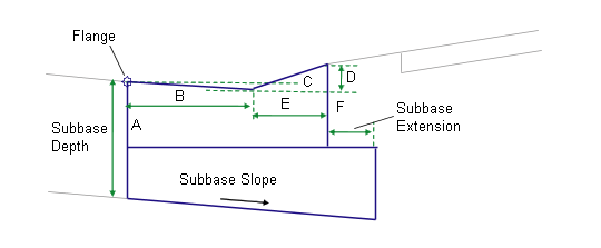

This subassembly inserts links for a flat-bottomed valley curb and gutter with subbase.
User-defined input parameters control the dimensions of the shape.

Dimension A |
Depth of the gutter at the flange point |
Numeric, positive, non-zero |
175 mm 7 in |
Dimension B |
Width from the gutter flange point to the gutter flowline |
375 mm 15 in |
Dimension C |
Depth from the gutter flange point to the gutter flowline |
25 mm 1 in |
Dimension D |
Height from the gutter flowline to the top-of-curb |
75 mm 3 in |
Dimension E |
Width from the gutter flowline to the top-of-curb |
250 mm 9 in |
Dimension F |
Height of the back-of-curb |
250 mm 9 in |
Behavior
The curb and gutter links are inserted based on the Input Parameter dimensions Dimension A – Dimension F. All dimensions must be positive, non-zero values. If a non-zero subbase depth is given, the subbase layer is inserted to the back of curb, and continues for the Subbase Extension width. The subbase layer closes to the bottom-back-of-curb, as shown in the diagram.
The subassembly builds the shape for a simple curb and gutter, with the attachment point either at (a) inside edge of the gutter (or lip), or (b) the back of the curb. The face of the curb is given a small, constant width to make it non-vertical.
