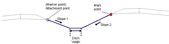

This subassembly is used to insert intersecting links between two points.
It is typically used to place intersecting slopes to a V-ditch between the edges of two adjacent or merging roadways. A flat-bottomed ditch can also be specified.
The attachment point is at the outside edge of either the left or right intersecting slope, and the previously defined marked point must be on the opposite outside edge. It does not matter which point is left or right of the other. When prompted for marker point, choose attachment point. Be sure to name the marked point and set the marked point name in this subassembly.

Slope 1
Slope (x : 1) of the link extending inward from the attachment point. Negative slope values are downward.
Numeric
-4 ( : 1)
Slope 2
Slope (x : 1) of the link extending inward from the marked point
Numeric
-4 ( : 1)
Ditch Width
Width of the bottom of the median ditch (zero for a V-ditch)
Numeric, positive
0.6 m
2 ft

Behavior
The locations of the attachment point and marked point are determined. The marked point may be either to the right or left of the attachment point. Links are extended inward at Slope 1 from the attachment point, and Slope 2 from the marked point, until they intersect. If a non-zero ditch width is given, a horizontal bottom-of-ditch link is fit into the intersecting side slopes.
Layout Mode Operation
In layout mode, this subassembly calculates and displays the intersecting links and optional ditch bottom based on the input parameters given and the relative locations of the attachment and marked points.

P2
Ditch_In
Ditch
For non-zero ditch width, the edge of ditch closest to the attachment point.
If the ditch width is zero, use Ditch.
P3
RMedDitch
For non-zeroditch width, the edge of ditch closest to the marked point
L1 – L3
Top
Datum
Finish grade on unpaved shoulder and median links
