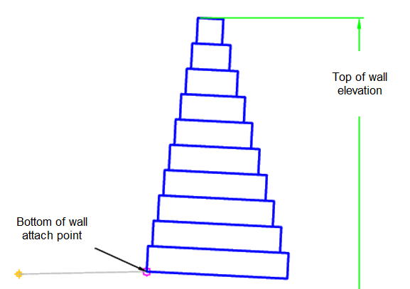

Case: Attachment at Top of Wall

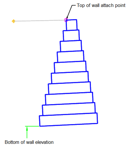

Case: Attachment at Bottom of Wall
The attachment point is at the inside edge of the initial cut or fill slope. This component can be attached to either the left or right side.

Attachment Place Attachment place on wall TopOfWall / BottomOfWall Bottom Of Wall

Top of Wall Elevation May be used to set the top of wall elevation when the attachment point is set to bottom of wall. The following object types can be used as targets for specifying the elevation: profiles, 3D polylines, feature lines, or survey figures. Required when attachment point is Bottom of Wall
Bottom of Wall Elevation May be used to set the bottom of wall elevation when the attachment point is set to top of wall. The following object types can be used as targets for specifying the width: alignments, polylines, feature lines, or survey figures. Required when attachment point is Top of Wall

The initial hinge point is set at the attachment point. The gabion wall height is then calculated from the attachment point and the top of wall or bottom of wall profile. The maximum number of gabion layers is 10 and is split up into 3 ft (1 m) layers. Gabion wall height is rounded up to an even number of layers.
Each gabion layer is then built based on the input parameters.
