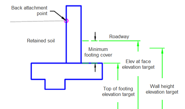

Case 1: Attachment point at back of retaining wall

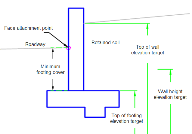

Case 2: Attachment point at face of wall

The attachment is set at either the back of the retaining wall or the front.

Minimum Footing Cover For Back facing, this parameter determines the height above the footing if no Elev At Face elevation target is set. Numeric, positive
1.5 ft
0.45 m
Attachment Point Specifies if the attachment point is on the face of the retaining wall or the back of the retaining wall. Face / Back Back

Wall Height Used to control the height dimensions used to build the retaining wall. The following object types can be used as targets for specifying the elevation: profiles, 3D polylines, feature lines, or survey figures. Required
Top of Footing May be used to control the top of footing elevation. The following object types can be used as targets for specifying the elevation: profiles, 3D polylines, feature lines, or survey figures. Required
Top of Wall May be used to override the top of wall elevation when the Attachment Point is Face. The following object types can be used as targets for specifying the elevation: profiles, 3D polylines, feature lines, or survey figures. Optional
Elev at Face May be used to control an elevation point at the face of wall when the Attachment Point is Back. The following object types can be used as targets for specifying the elevation: profiles, 3D polylines, feature lines, or survey figures. Optional
If the Elev at Face target is set the elevation is used. If the Elev at Face is not set then the Top of Footing plus the minimum footing cover is used. The top of footing target elevation is used to determine the physical height of the retaining wall. The footing builds using the standard plan dimensions based on the Wall Height Target.
The calculation for the top of wall is performed based on the Top Wall Target. The footing elevation is based on the Top of Footing Target. If the Top of Footing Target is not found then the Minimum Footing cover is used below the Attachment Point. The footing builds using the standard plan dimensions based on the Wall Height Target.
