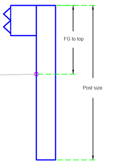

The ClarkCountyGuardrailType31 subassembly inserts links to create a Clark County Guardrail, Type 31, shape on the assembly.
You should verify that the dimensions used match your interpretation of the standard plan.
The attachment point is at the inside edge of the post at finish grade level.
Input Parameters
Note: All dimensions are in meters or feet unless otherwise noted. All slopes are in run-over-rise form (for example, 4 : 1) unless indicated as a percent slope with a “%” sign.
Parameter
Description
Type
Default
Side Specifies which side to place the subassembly Left / Right Right
Post Size Dimensions of post Numeric, positive
6 ft
1.8 m
FG to Top Finish grade to top of post Numeric, positive
2.67 ft
0.8 m

The subassembly builds two rectangular shapes for the post and railing in addition to the rail shape. The post extends downward from the attachment point for a fixed distance below finish grade. The post extends upward the specified distance in the parameters.
Layout Mode Operation
In layout mode, this subassembly draws the post and rail with the fixed dimensions.

P5 Grail_Face_Top Top guardrail face
P7 Grail_Face_Btm Bottom guardrail face
P10 Post_Top_In Inside top of the post
P11 Post_Top_Out Outside top of the post
P12 Post_Btm_Out Outside bottom of the post
P13 Post_Btm_In Inside bottom of the post
S1 Post Post
S2 Block Block
