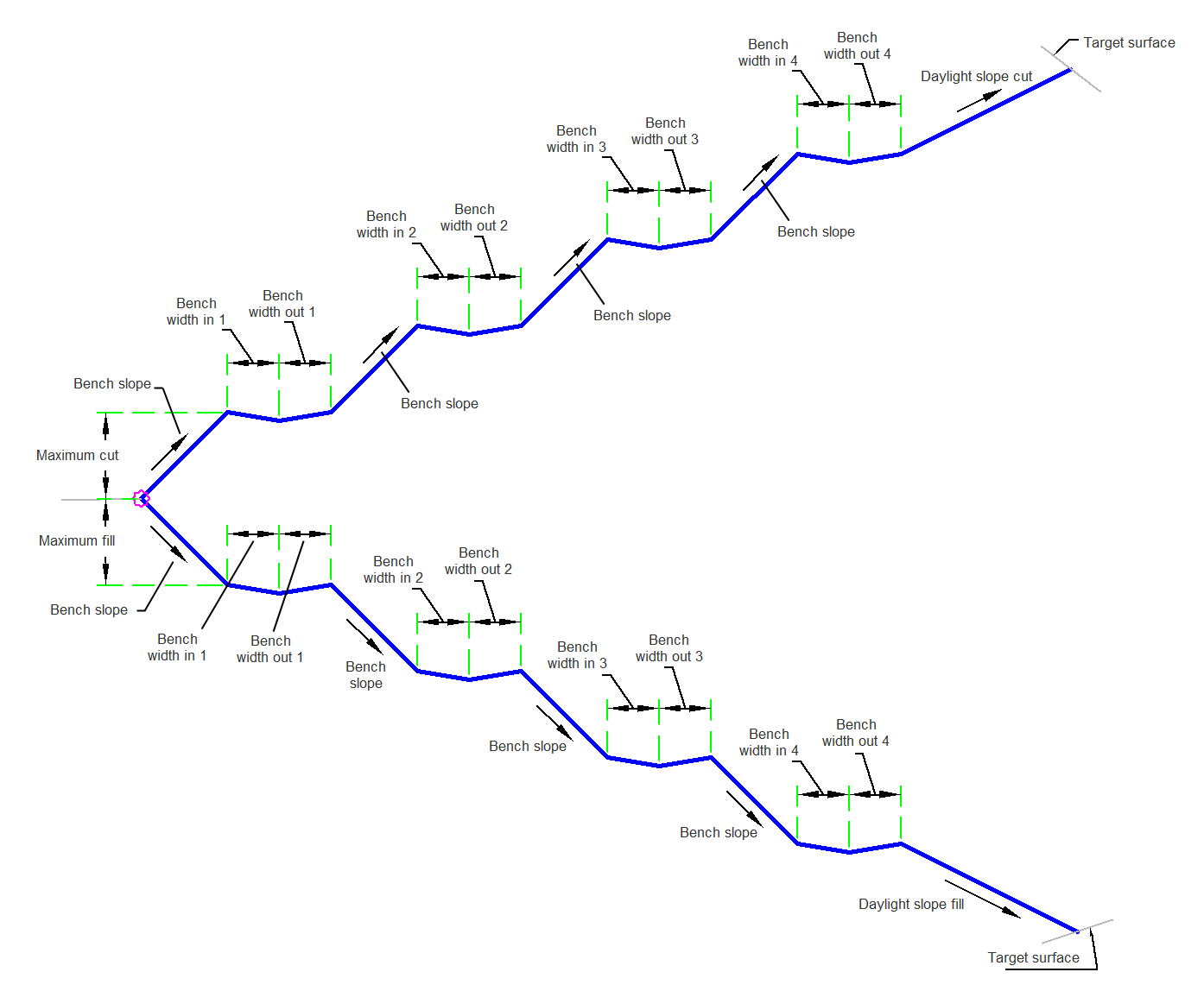

The MultipleBench_Depth subassembly creates cut or fill catch slopes with benches with varying bench slopes, swale widths, and swale depths.
You can define a swale width and depth at the benches. The last daylight slope to the target surface may be different than the bench slope.
The attachment point is at the inside edge of the initial cut or fill slope. This component can be attached to either the left or right side.

Behavior
The initial hinge point is set at the attachment point. The hinge point elevation is checked against the target surface to determine if the section is in the cut or fill condition. An intercept is calculated to the target surface using the given Daylight Slope.
If the height to the intercept exceeds the Max Daylight Height, the link with the Bench Height is inserted, and the bench is added. The hinge point is reset to the outside edge of the bench and the process is repeated until a daylight link is found that does not exceed the Max Daylight Height.
At each bench the entered input values are used to determine slopes and depths. After four benches the Daylight Slope Cut or Daylight Slope Fill is used to daylight and no more benches are added.

P1 Hinge
P2, P5, P8, P11 Bench_In
P3, P6, P9, P12 Ditch
P4, P7, P10, P13 Bench_Out
P25 - P29 Daylight
L1, L4, L7, L10 Top, Datum, Bench
L2, L3, L5, L6, L8, L9, L11, L12 Top, Datum, Swale
L24 - L28 Top, Datum, Daylight
