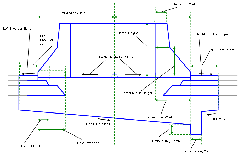

This subassembly is used to insert a median at the centerline, with asymmetrical barriers on either side of the centerline, and a tapered bottom with an optional key.
The pavement structure follows the standards described in “Pavement Structure of Paved Sections" in the Autodesk Civil 3D Help.
The attachment point is at the middle of the median. The median is placed on either side with appropriate components as specified by the input parameters.

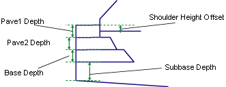

Shoulder Height Offset | Difference in the median edge point elevation with respect to edge of paved shoulder | Numeric |
0.015 m 0.05 ft |

Left Pave1 Depth | Depth between finish grade and Pave1 for the left shoulder | Numeric, positive |
0.025 m 0.083 ft |
Left Pave2 Depth | Depth second level pavement material for the left shoulder | Numeric, positive |
0.025 m 0.083ft |
Left Base Depth | Depth of base course (between Pave2 and Base) for the left shoulder | Numeric, positive |
0.100 m 0.333 ft |
Left Subbase Depth | Depth of the subbase layer at the left inside edge of pavement (start of the left shoulder). If shoulder width is set to zero , then this is the depth of the subbase at left end of the median. | Numeric |
0.300 m 1.0 ft |

Behavior
This subassembly is inserted on both sides of attachment point, starting with the median links, using left/right median widths and other parameters. Edge of paved shoulder will be located (on both right and left sides) using Shoulder Height Offset parameter value. The finish grade of the shoulder is inserted for the given Shoulder Width and Shoulder Slope outward from the attachment point. The subbase link is inserted from the outer most point on the paved shoulders starting at the “Subbase Depth”, for left and right sides respectively, below the finish grade.
The Pave1, Pave2, and Base surface links are inserted parallel to the finish grade at the given depths. If the layer Extension values are non-zero, each layer is extended for the given distance beyond the shoulder hinge point. Each layer should be as wide as or wider than the one above it.
Finally, Barrier links are added from the end of the medians using the barrier bottom width, height, middle width, middle height and curb height parameters.

Point, Link, and Shape Codes
The following table lists the point, link, and shape codes for this subassembly that have codes assigned to them. Point, link, or shape codes for this subassembly that do not have codes assigned are not included in this table.
Type | Codes | Description |
P1 | Crown | Insertion point and typically at the centerline |
P2, P3 | EPS | Edge of paved shoulder on top links |
P4, P5 | Median | Edge of median |
P6, P7 | EPS_Pave1 | Edge of paved shoulder on Pave1 |
P10, P11 | EPS_Pave2 | Edge of paved shoulder on Pave2 |
P14, P15 | EPS_Base | Edge of paved shoulder on Base |
L1, L2, L17, L18 | Top | Top link on the median portion including barriers |
L3-L7; L19-L23 | Barrier | Barrier Links |
L8, L24 | Top, Pave | |
L9, L25 | Pave1 | Bottom of first pavement layer |
L10, L26 | Pave2 | Bottom of second pavement layer |
L11, L27 | Base | Bottom of base course layer |
L12, L14, L16 | SubBase | Bottom of subbase course layer |
S1 | Pave1 | |
S2 | Pave2 | |
S3 | Base | |
S4 | SubBase | |
S5 | Barrier |
