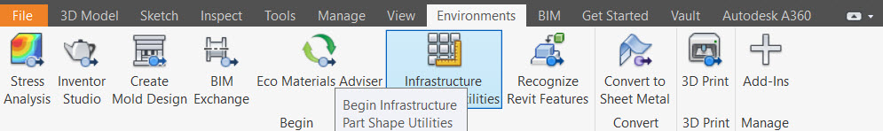

You can now access the Infrastructure Part Shape Utilities tools through the Environment tab in the Autodesk Inventor Ribbon.

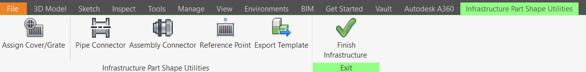

To access the Infrastructure Part Shape Utilities tools
- Close Autodesk InfraWorks.
- Open Autodesk Inventor.
- Click the Environments Tab in the Autodesk Inventor Ribbon.
- Click Infrastructure Part Shape Utilities.
- The Infrastructure Part Shape Utilities tools are now available to use.
