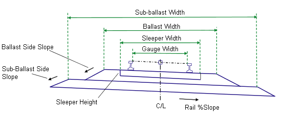

This subassembly inserts the rails, sleeper, ballast, and sub-ballast for a single-track railroad.
It should be followed with a Daylight subassembly on the left and right sides to close to existing ground in cut and fill situations.

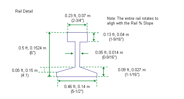

The attachment point is at a distance equal to the rail height above the centerline of the sleeper.

Parameter |
Description |
Type |
Default |
Rail % Slope |
% slope of the roadbed |
Numeric |
0 (%) |
Gauge Width |
Width of the rail gauge from inside-to-inside rail. The rails are placed symetrically about the centerline alignment. |
Numeric, positive |
1.435 m 4.7083 ft (4’ 8-1/2”) |
Sleeper Width |
Width of the sleeper, placed symetrically about the centerline |
Numeric, positive |
2.4 m 8.0 ft |
Sleeper Height |
Height of the sleeper |
Numeric, positive |
0.200 m 0.67 ft |
Ballast Width |
Width of the top of the ballast layer, placed symetrically about the centerline |
Numeric, positive |
3.6 m 12.0 ft |
Ballast Depth |
Thickness of the ballast layer from finish grade |
Numeric, positive |
0.3 1.0 ft |
Ballast Side Slope |
Side slope (x : 1) of the ballast layer |
Numeric, positive |
2 (: 1) |
Sub-ballast Width |
Width of the top of the sub-ballast layer, placed symetrically about the centerline |
Numeric, positive |
6.6 m 22.0 ft |
Sub-ballast Depth |
Thickness of the sub-ballast layer |
Numeric, positive |
0.3 1.0 ft |
Sub-ballast Side Slope |
Side slope of the sub-ballast layer |
Numeric, positive |
2 (: 1) |

The links for the rails, sleeper, ballast, and sub-ballast are calculated and placed based on the input parameter values provided. If the Rail %Slope is non-zero, the corridor profile elevation is held at the center of the rail on the low side. The finish grade, sleeper, ballast, and sub-ballast links are maintained at the Rail %Slope.
Layout Mode Operation
In layout mode, this subassembly displays the links comprising the finish grade, ballast, sub-ballast, and side slopes.
