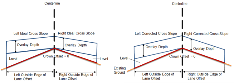

Flapping Within Tolerance:
Note: Because the slope difference between the existing ground cross slope and the ideal cross slope is within slope tolerance, the two sides of the road will output different corrected cross slopes relative to the existing ground (EG) surface cross slope for each side of the road. Each side of the road will have corrected cross slope set as close to the existing ground cross slope as possible.

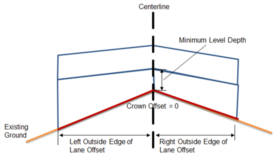

Minimum Level Depth
Note: The minimum level depth represents the minimum depth of the leveling layer, measured between the existing ground high point and the bottom of the overlay layer.

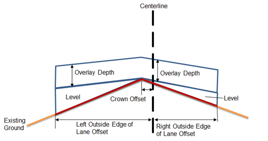

Crown Offset
Note: The distance that the crown point for the subassembly is offset from the road centerline.

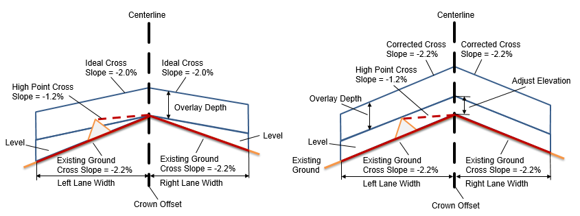

This subassembly assumes that no milling layer is added to the subassembly.
Inputs:
Inputs Value
Ideal Cross Slope, Left -2.0%
Ideal Cross Slope, Right -2.0%
Crown Offset 0.000' (0.00m)
Left Lane Width 12' (3.6m)
Right Lane Width 12' (3.6m)
Minimum Level Depth 0.000' (0.00m)
Slope Tolerance 0.50%
Overlay Slope Options User Defined With Flapping
Use Profile Options Minimum Level Depth
Calculations:
Left Side Input Value
Existing Ground Cross Slope -2.2%
Existing Ground Cross Slope - Ideal Cross Slope 0.2%
High Point Cross Slope, measured from Crown Point to High Point -1.2%
High Point Cross Slope - Ideal Cross Slope 0.8%
Slope Tolerance The Slope Difference between the Existing Ground Cross Slope minus Ideal Cross Slope result is 0.2%, which is less than the Slope Tolerance of 0.50%
Corrected Cross Slope
The Corrected Cross Slope will be adjusted to -2.2
Right Side Input Value
Existing Ground Cross Slope - Ideal Cross Slope -0.2%
Tolerance Existing Ground Slope minus Ideal Cross Slope is -0.2%, which is less than the Slope Tolerance of 0.5%
Corrected Cross Slope The Corrected Cross Slope will be adjusted to -2.2%
Final Input Value
Corrected Cross Slope, Left -2.2%
Corrected Cross Slope, Right -2.2%
Adjust elevation The elevation will be adjusted because of the high point elevation on the left side.
Output
Output Value
