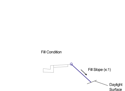

The attachment point is tested to determine if it is in cut or fill. If it is in fill, the fill daylight link is extended to the Existing Surface at the given Fill Slope.

The following coding diagram shows the codes in a fill situation.
