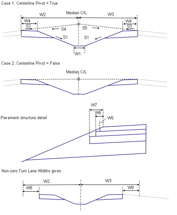

Superelevation Pivot Point
The median can be configured to have the pivot point at the centerline, or at the inside edges of traveled ways. If Centerline Pivot is used, the left and right outside lane superelevation slopes are obtained from the baseline’s superelevation specifications, and the elevations of the inside edges-of-traveled-ways are calculated by applying these slopes to the left and right median widths from the attachment point. If Centerline Pivot is not used, the edges-of-traveled-ways are held to the elevation of the attachment point.

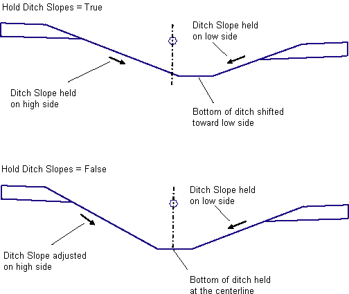

Ditch Elevations and Slopes
Superelevation or turning lanes may cause the top of the ditch slopes to be at different elevations on the left and right sides, resulting in an asymmetrical ditch. There are two options for handling this situation. If Hold Ditch Slopes is set to True, then the given ditch slopes are held constant on both sides, which shifts the bottom of ditch away from the centerline towards the lower side. If set to False, the ditch bottom is centered about the median centerline, the given slope is held on the lower side, and the slope is adjusted to match on the higher side.

The paved shoulders follow the slopes defined for the left and right inside shoulder slopes for the baseline alignment’s superelevation specifications. These slopes are applied inward from the inside edges of traveled ways. The subbase surfaces follows the same slope as the finished grade, and is extended inwards to the intersections with the ditch slopes.

In layout mode, this subassembly calculates and displays the median and shoulders based on the input parameters given, with lane slopes of -2%, paved shoulder slopes of -5%, and turning lane widths of zero.

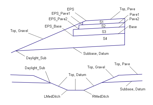

Point, Link, and Shape Codes
The following table lists the point, link, and shape codes for this subassembly that have codes assigned to them. Point, link, or shape codes for this subassembly that do not have codes assigned are not included in this table.
Point, Link, or Shape |
Code |
Description |
Points |
As shown below |
Links |
As shown below |
S1 |
Pave1 |
S2 |
Pave2 |
S3 |
Base |
S4 |
SubBase |
