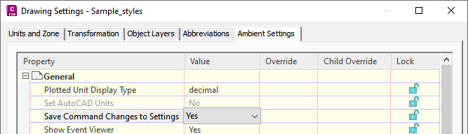

  1. On the Toolspace Settings tab, right-click the drawing name. Click Edit Drawing Settings.
  2. Click the Ambient Settings tab, and expand the General property. Set the Save Command Changes To Settings property to Yes as shown in figure 11.
    Figure 11: Use command settings to set default styles
