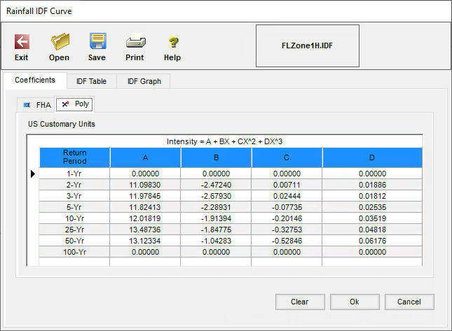

The Hydraflow Extensions include a Rainfall Intensity-Duration-Frequency (IDF) Curve dialog box, used for entering rainfall data and/or importing files that contain rainfall data. In the Rainfall IDF Curve dialog box, as shown in figure 6, there are equations you can use to create an IDF graph. You can also enter rainfall data at a constant rate instead of using the default IDF graph.
Figure 6: Default IDF Graph
