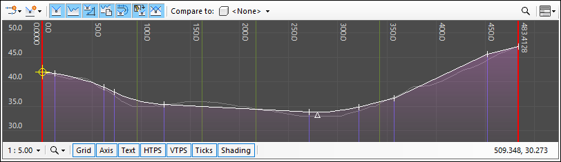

Profile view
The Profile View in the Alignments tab displays all profiles directly associated with the currently selected alignment or profile. If no profiles are associated with the selected alignment, the station extents of the alignment and every alignment entity are displayed as vertical lines across the canvas instead. Unselected profiles associated with the currently selected alignment or profile are displayed in the secondary profile color (grey by default). If a profile is currently selected, that profile is displayed in the primary profile color (white by default).
Use the Profile Type Visibility check buttons to include or exclude different types of profile from the alignments and profiles list.
Using compared objects
To compare the station and elevation of points on the selected profile with other elements of your design, use the drop down list of objects adjacent to the Compare To label to select another alignment, profile, or surface in the current drawing. This will cause a compared profile line to be drawn on the profile view indicating the relationship between the compared object and the displayed profile. Additionally, the Calculated Stations list of points for the selected alignment or profile will show the compared elevation values and other relevant details for each displayed point.

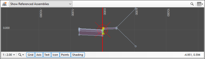

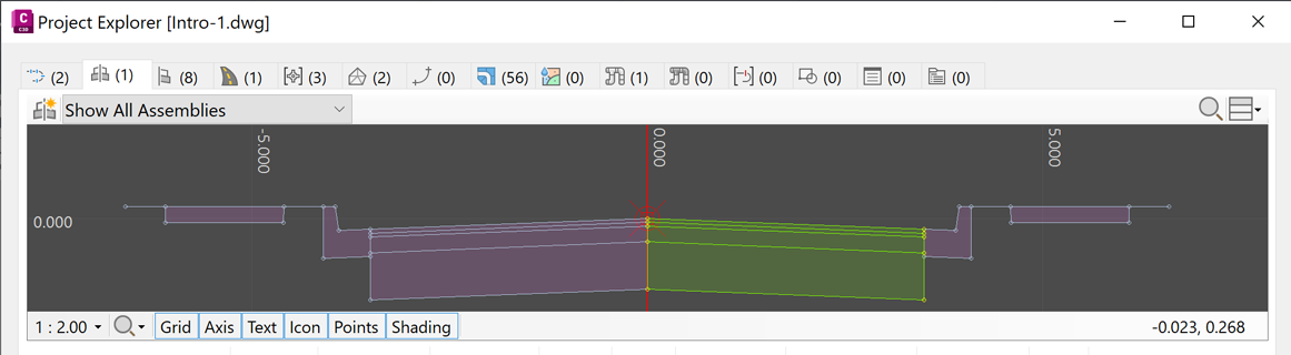

Assembly view
The Assembly View in the Assemblies tab displays a dynamic section through all subassemblies associated with the currently selected assembly. Any subassembly which is selected in the subassemblies list is highlighted on the view canvas to allow for easy identification. Any changes made to any parameter on any of the display subassemblies are reflected in the Assembly View instantly.
Use the drop down list in the Assembly View toolbar to determine whether the Assemblies list should include all assemblies, or just referenced, unreferenced, or assemblies with or without violations. An unreferenced assembly is one which is not in use by any corridor regions in the current drawing.
Subassembly View
The Assembly View in the Assemblies tab displays a dynamic section through all subassemblies associated with the current drawing. If more than one subassembly is selected, a message will be displayed in the top left of the section view stating "Multiple Subassemblies are selected".

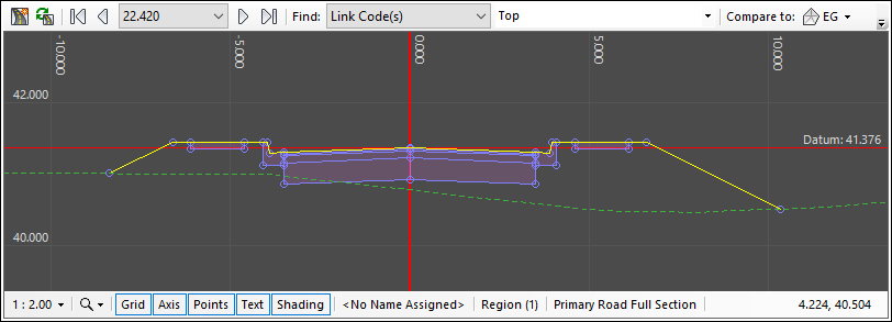

Corridor section view
The Corridor View in the Corridors tab displays a dynamic section through the selected corridor at a range of station or chainage locations. Use the forward/back arrows or drop-down list of available stations in the Corridor to select the station at which to display a section. The Find option in the toolbar can then be used to highlight specific point, link or shape codes on the Corridor View. Codes can either be selected from a drop-down list, or typed into the field as a comma delimited list where multiple codes need to be highlighted.
To compare the offset and elevation of points on the selected corridor section with other elements of your design, use the drop down list of objects adjacent to the Compare To label to select any surface from the current drawing. This will cause a compared section line to be drawn on the Corridor View indicating the relationship between the compared surface and the displayed section. Additionally, the feature line points list for the selected corridor will show the compared surface elevation values and other relevant details for each feature line point.

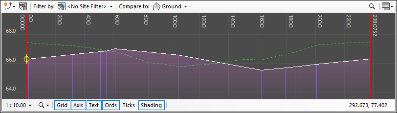

Feature line view
The Feature Line View in the Feature Lines tab displays a dynamic profile through any selected feature line. Use the site filter in the main toolbar to limit the list of feature lines to all, or to specific sites in the current drawing. Use the editing tools from the right-click menus on the feature lines list or feature line points list to apply changes to the elevation of one or more displayed points.
To compare the station and elevation of points on the selected feature line with other elements of your design, use the drop down list of objects adjacent to the Compare To label to select another alignment, profile, or surface in the current drawing. This will cause a compared profile line to be drawn on the feature line view indicating the relationship between the compared object and the displayed feature line. Additionally, the feature line points list for the selected feature line will show the compared elevation values and other relevant details for each displayed point.

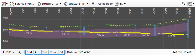

Pipe Network (Pipe Run) view
The Pipe Run View in the Pipe Networks tab displays a dynamic profile along the shortest pipe route between two structures in the selected pipe network. Use the drop-down structure lists in the toolbar to selected a start and end structure for the pipe run. Use the Edit Pipe Run option to adjust the slope of any pipes displayed in the current pipe run.
To compare the station and elevation of points on the selected pipe run with other elements of your design, use the drop down list of objects adjacent to the Compare To label to select any surface from the current drawing. This will cause a compared profile line to be drawn on the Corridor View indicating the relationship between the compared surface and the displayed pipes and structures. Additionally, the pipe run interval list for the selected pipe run will show the compared surface elevation values and other relevant details for each point on the pipe run.

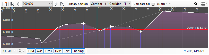

Sample line group section view
The Sample Line Group Section View in the Sample Line Groups tab displays a dynamic section through the selected sample line group at any sample line location. Use the forward/back arrows or drop-down list of available sample line stations to select the station at which to display a section. The Primary Section list in the toolbar can then be used to highlight specific point, link or shape codes on the Corridor View. Codes can either be selected from a drop-down list, or typed into the field as a comma delimited list where multiple codes need to be highlighted.
To compare the offset and elevation of points on the selected sample line section with other elements of your design, use the drop down list of objects adjacent to the Compare To label to select any surface from the current drawing. This will cause a compared section line to be drawn on the Corridor View indicating the relationship between the compared surface and the displayed section. Additionally, the section points list for the selected sample line will show the compared surface elevation values and other relevant details for each section point.
